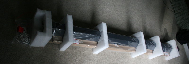

Cosmo_protectThe Tensioned Cosmopolitan Electrol arrived as you might expect, in a long, thin box. The screen housing was mounted to a large piece of MDF and surrounded at the ends with foam endcaps and along the length by foam ribs. Provided that your delivery driver isn't completely incompetent, the screen should arrive with no damage.

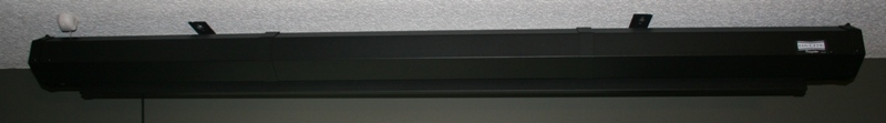

Cosmo_endThe screen is housed in a larger black aluminum case (though white and custom finishes are available). The screen is heavy, but not overly so. The case is sturdy and well made. There is an identification placard on the right with removable endcaps. On the left endcap there is a removable place that covers the connection points for the IR receiver, wall control plate, and power connection. You'll need to provide your own power cord (we just got a standard three-prong 12-gauge extension cord from our local home improvement store and stripped one end).

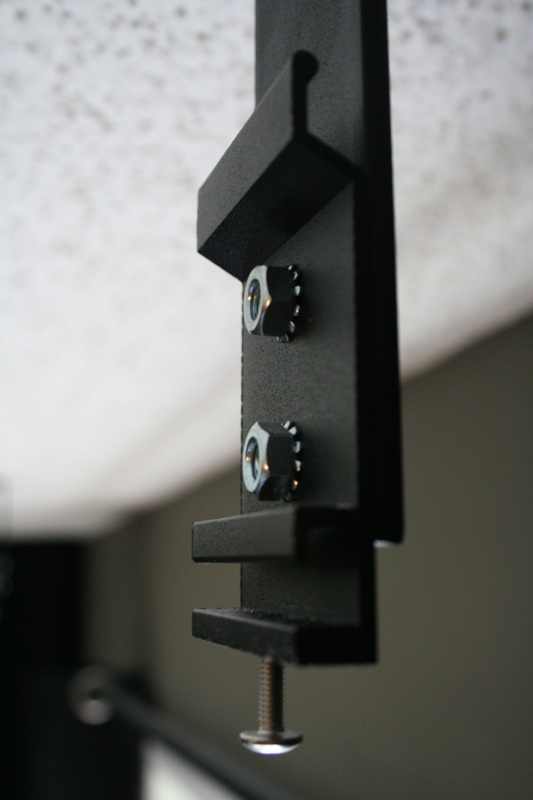

There are a few different mounting options with the Tensioned Cosmopolitan Electrol. The endcaps have holes for hanging from the ceiling using hooks and/or chain. You can use the same holes for wall mounting to a #6 bracket. The same endcap has holes flush to the back wall for wall mounting either in the room or recessed in the ceiling. We opted for the optional floating ceiling mount. What this does is add a rail to the back of the unit from the edges to about a third of the way in. You can then add to "L" shaped brackets that connect to the ceiling and the rail. This gives you a lot more flexibility in placement plus the ability to move the screen from side to side at a later time without having to reinstall it. Think that isn't important? Wait until you upgrade your projector and find out the new one has the lens on the opposite side as your old one. For an $84 upgrade, this is well worth it in our opinion.

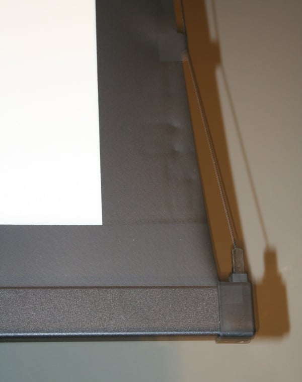

Cosmo_bottomThe "tensioned" part of the Tensioned Cosmopolitan Electrol are the cables that run up the sides of the screen. This limits the side to side movement and flexing of the screen due to air turbulence. For the uninitiated, they tend to think that this will make the screen as tight as a drum. That's not the case. The string pulls gently on the screen to keep it in place but not so tight that it will stretch or warp it. There are adjustment screws at the bottom of the screen on each side for tightening at a later time.

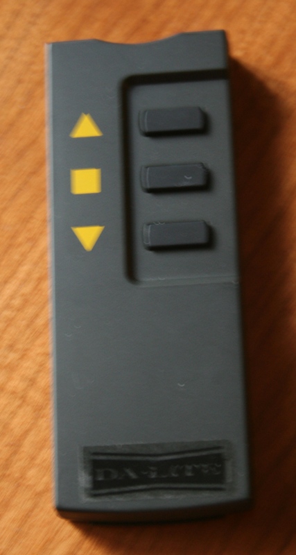

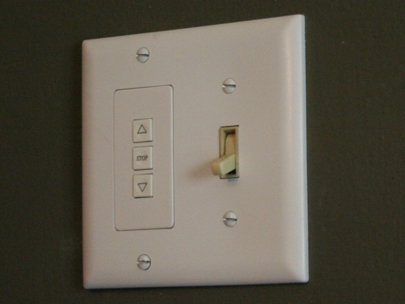

You have two options for remote control of the Tensioned Cosmopolitan Electrol screen - IR or 12 volt. Because of the challenges with integration, you can have one but not the other. In our case we went with IR as not every projector has a 12 volt trigger. All of the screens come with a standard wall control. This is a pretty easy installation as it is a phone-type jack with a good bit of cable for in-wall/in-ceiling installation. We ended up just buying double-gang 1/2 Decora-style, 1/2 light switch cover and added the wall control to an existing light switch in the room. The remote is of the throw-away variety - utilitarian at best. Black, non-backlit, and frankly fugly, it is meant to be used to program into a universal remote system and then placed in a drawer to be forgotten.

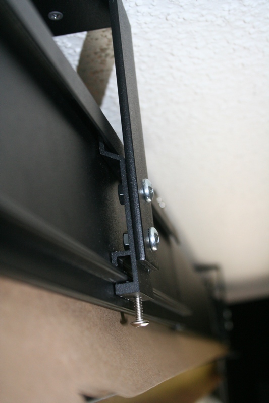

The floating bracket really made setting up the Tensioned Cosmopolitan Electrol screen a lot easier than it could have been. If we had been using the endcaps, we'd have to find at least one joist and hope to find another on the other side. With the floating mount, we just found two that we knew would hit near the middle of the mounting rails and installed them. Once we got the screen on, we were able to move it from left to right to help center it as needed. This will also be useful later as we get new projectors in for review. A projector without horizontal lens shift can be aligned to the screen by loosening the two screws on the floating mount and sliding the screen over a bit. A simple solution to an annoying problem. For normal consumers, the $84 for the floating mount is insurance for future projector purchases and makes for a really, REALLY easy install.

One thing you want to be sure of when you install the wall control is that you've set the level of the screen before finishing the installation. On the back of the wall controls there are adjustments so that you can set the drop and the rise of the screen. This is imperative for some installations. While it is not a big deal to remove the plate and make those adjustments later, better to get it out of the way up front.

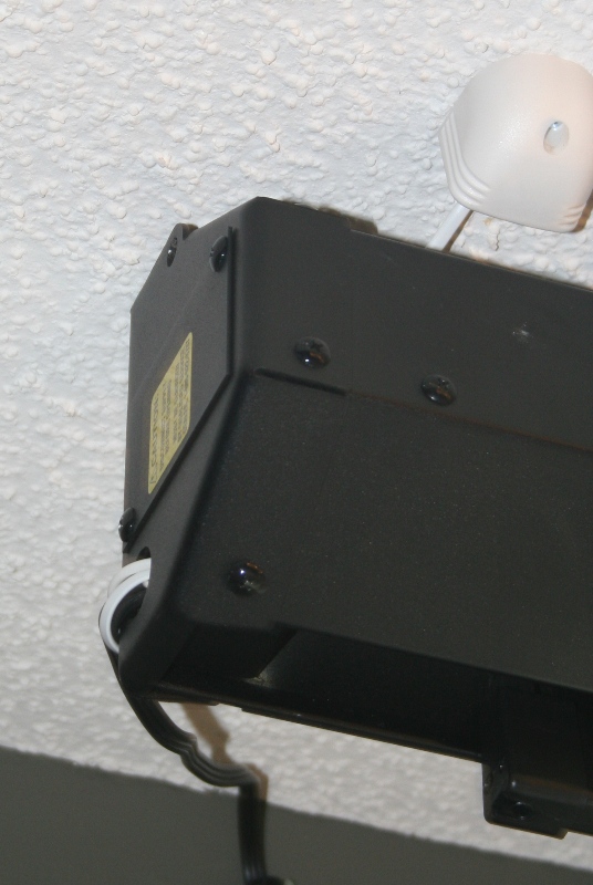

Cosmo_IRWe mounted the IR sensor to the ceiling right above the screen case. While it doesn't really blend, it isn't too bad. We'd like to see an option to include the sensor in the enclosure in future Tensioned Cosmopolitan Electrol offerings. The cable provided was also very long (like the wall control) though we were able to fit it all inside the endcap (with a little assertiveness).
