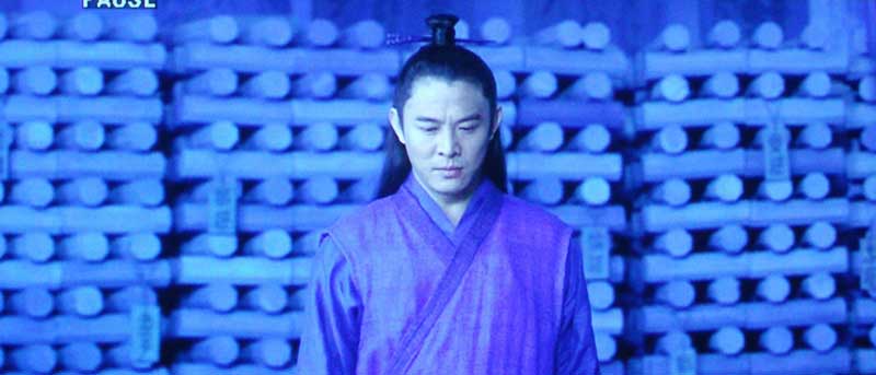

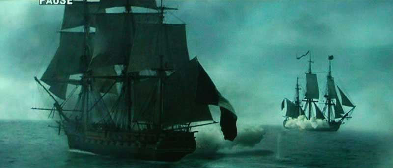

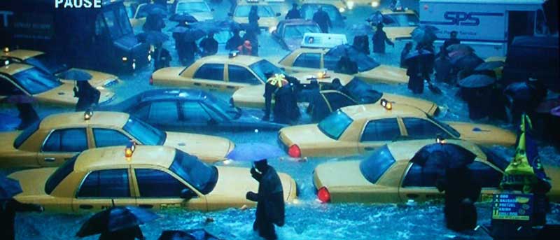

While I'd love to go over every nuance and detail I experienced while watching movies on the Criterion screen, I'll save the evaluations for the DVD and projector reviews. Suffice it to say, the Carada Criterion performs a superb job of giving back the light it receives. The goal of any screen is to accurately portray the picture you are projecting - and the Criterion does that with flying colors (pun intended.) Featured here are some images I snapped that show the excellent color and detail that can be realized from this screen. Our camera, a Pentax Optio S5i doesn't perfectly capture the colors due to the limitations of the camera, but it gives you a taste.
