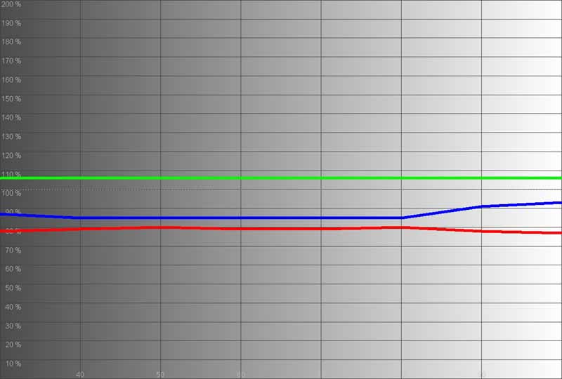

RGB before

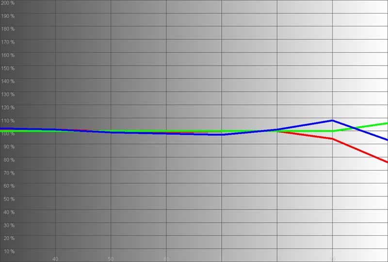

RGB after
You don't want green to be your dominant color. Just about any other color would be better. When viewing real world images, the picture didn't appear to have a green tint.
We were able to really dial in all but the highest extreme of the Planar projector. The calibration "stuck" better than most projectors I've tested of late.

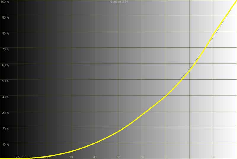

luma before

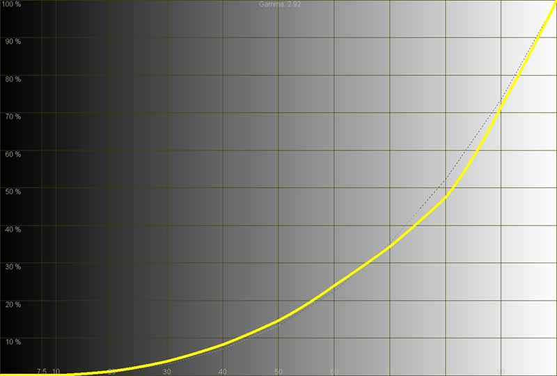

luma after
The initial luminance graph isn't bad except for a slight dip around 80IRE from what we'd be looking for.
After calibration the chart is nearly spot on.

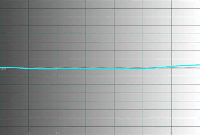

color temp before

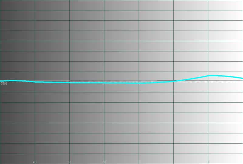

color temp after
Color temp measured an incredibly "out of the box" accurate 6400K across most of the range.
You can argue that dialing in the projector, while balancing the levels up to 80IRE, actually caused a slight shift into the 6800K range for 90 and 100 IRE.
Only the very top end of the projector seemed to go a bit off during calibration and we noticed that backing down the Contrast and re-running calibration seemed to do the trick. Keep this in mind when you run this projector. Full Contrast ratio measured "off the charts" for my sensor's reliability but we know that the real world reading was better than 1400:1.
