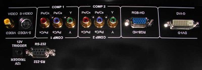

Microdisplay: Texas Instruments DLP® DarkChip3™ 0.8 720p 12o LVDS DMD
Native Resolution: 1280 x 720 (921,600 pixels)
Video Inputs: DVI-D, component (2), RGB/PC (HD15), S-video, composite
Aspect Ratios: Native (Pixel-to-Pixel), 16:9, Letterbox, 4:3, Anamorphic compatible (standard definition sources)
Projection Lens: All glass, F/2.4~2.50, f=19.1~23.9 mm, 1:25x manual zoom, made in Japan
Throw Ratio: 1.3 - 1.7 (distance/width)
Lens Shift: +/-15% (horizontal), + 100%, -65% (vertical, ceiling mounted)
Cooling Performance: High efficiency adaptive voltage side-to-side cooling with low system acoustic noise level (29dBA) and low light pollution cabinet
Video Lumens: 1000 ANSI max
Contrast Ratio: 5000:1 (max full on/full off)
Projection Modes: Front, Rear, Ceiling (front/rear)
Keystone (digital): +/-5 (horizontal), +/-5 (vertical)
Lamp: User replaceable 200/250W HPM (selectable), 3000 hour (eco) lifetime*
Video Processing: Pixelworks™ PW463 8-bit chip
Calibration: Full RGB gain/offset control (White Balance), Gamma (1.0, 1.5, 1.8, 2.0, 2.2, 2.35, 2.5, 2.8), Contrast, Color Temp (Presets 5K~10K and X,Y control for R,G,B,Y), Brightness
Misc: 12VDC trigger, RS-232 (9-pin)
Dimensions: 17.5" (445mm) L x 16.5" (420mm) W x 7.1" (180mm) H
Weight: 17.6 lb (8 kg)
  • True native 720p DLP
  • Deep blacks, rich colors
  • Consumer adjustment of RGB gain, cut
  • Variable gamma settings
  • Backlit remote with discrete power codes
  • No HDMI input (does have DVI-D with HDCP)
  • No support for downscaling 1080p/60 source material via DVI-D (support of 1080p/24 and 1080p/60 supported via component)
  • No 480i support via DVI-D
  • Awkward remote configuration and labeling
