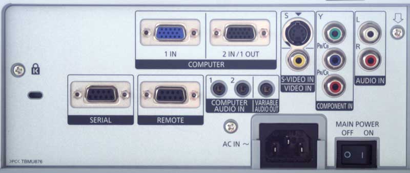

Next to the user-replaceable lamp compartment lie the inputs. Rear-mounted inputs seem to be standard now and typically make for a more convenient and flexible connection method.
Like its predecessor, the PT-F200U has two RGB/PC (HD15) inputs, one of which can be configured via software to be a pass-through output (HD15 male-male adapter or cable required). There are two audio inputs (1/8-inch mini jacks) which are permanently assigned to the HD15/PC inputs. A single 1/8-inch variable audio output lets the projector control the output levels for a presentation via the remote's volume button. Component video, S-video, and composite video are also present, along with a stereo RCA input which can be configured to any of the analogue video inputs. You may ask where the HDMI input is and the answer would be: not present. This projector is analogue only and you will not be able to use digital video sources without first converting to analogue. Most sources contain at least one analogue output so we don't think this is a big issue, especially given the target market for this projector.

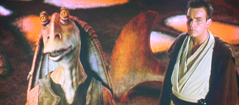

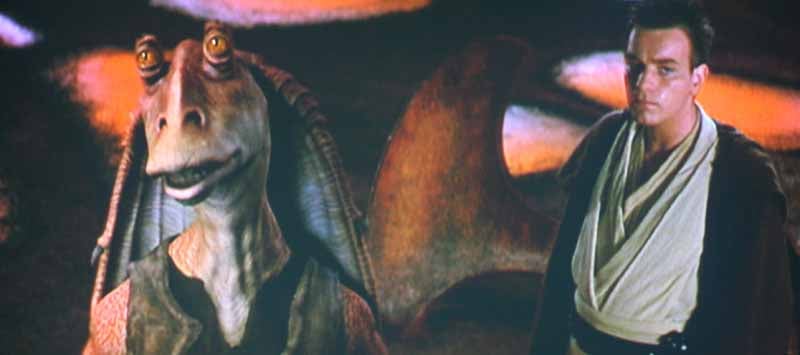

Panasonic upped the output of the new PT-F200U projector to 3500 ANSI lumens, which is considerably bright and very usable indoors without having to throw your clients or parishioners into complete darkness. In addition to the lumen output, Panasonic uses a brand new Daylight View 4 technology which I found to be very efficient and practical. Using the ambient luminance sensor (ALS) located on the top center of the projector, the PT-F200U can automatically adjust gamma and edge enhancement to allow images to adjust with changing ambient light conditions. While you can turn the function On or Off, I located at least 4 individual steps when using the Auto feature - and I'd recommend that setting for any conceivable business or house of worship use of the system.
Daylight View OFF
Daylight View ON
