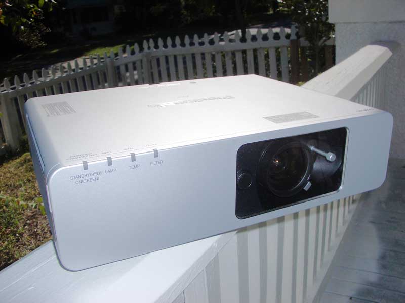

The Panasonic PT-F100U immediately impresses with its protective front panel cover that not only guards against dust and smudges on the front of the lens assembly, but also hides the functions you would not want accidentally altered such as zoom, focus, lens shift, input select and menu functions. For a commercial installation such as a church or office board room this is invaluable and, to put it simply, downright practical. Within the first few minutes, the PT-F100U had already aligned itself on a path to score a couple of 5’s on my rating checklist.

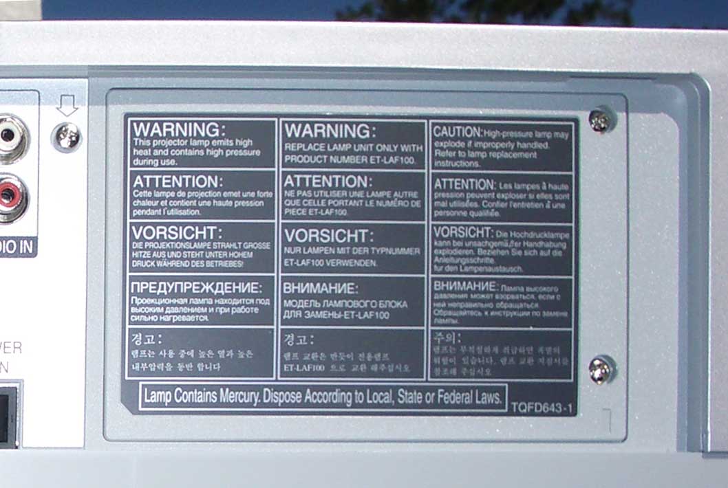

lamp-replace.jpgTaking a look at the rear of the projector you will notice a few things that will stand out clearly to anyone who has dealt with a commercially-installed projector. The lamp replacement compartment is located at the back of the projector. This means that there is no need to remove the system from a ceiling mount just to replace a bulb. Any projector intended for ceiling mount would do well to take this simple factor into consideration, especially with some of the 20-foot-plus ceilings I’ve seen in my time.

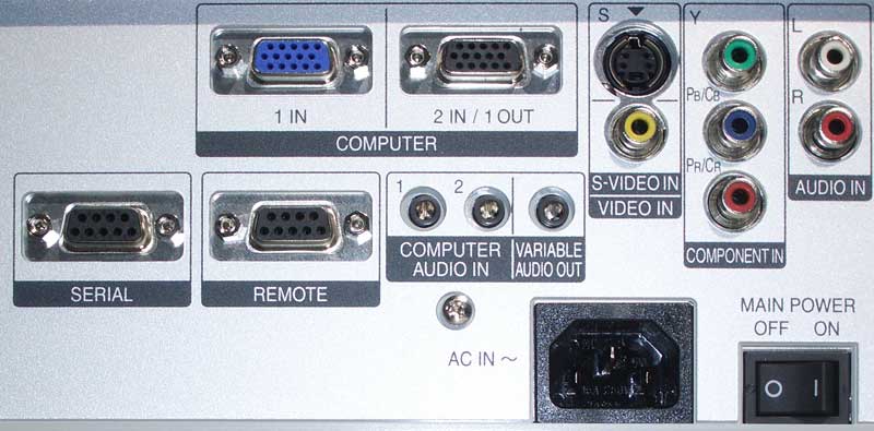

The lamp unit compartment sits next to the input panel. This projector is set up to handle all major analogue inputs types commonly utilized in the US. While HDMI is taking over the US consumer market I do not see this very often in strictly-commercial environments so I would not count this against the projector in the least. The inclusion of HDMI would simply result in increased cost due to the requirements it brings.
The PT-F100U has two RGB/PC (HD15) inputs, one of which can be configured, via software, to be a pass-through output. There are two audio inputs (1/8-inch mini jacks) which are permanently assigned to the HD15 inputs. A variable audio output allows the projector to control the volume level for a presentation via the remote. A component video input, S-video, and composite video is also present, along with a stereo RCA input which can be configured to either of these three analogue inputs.

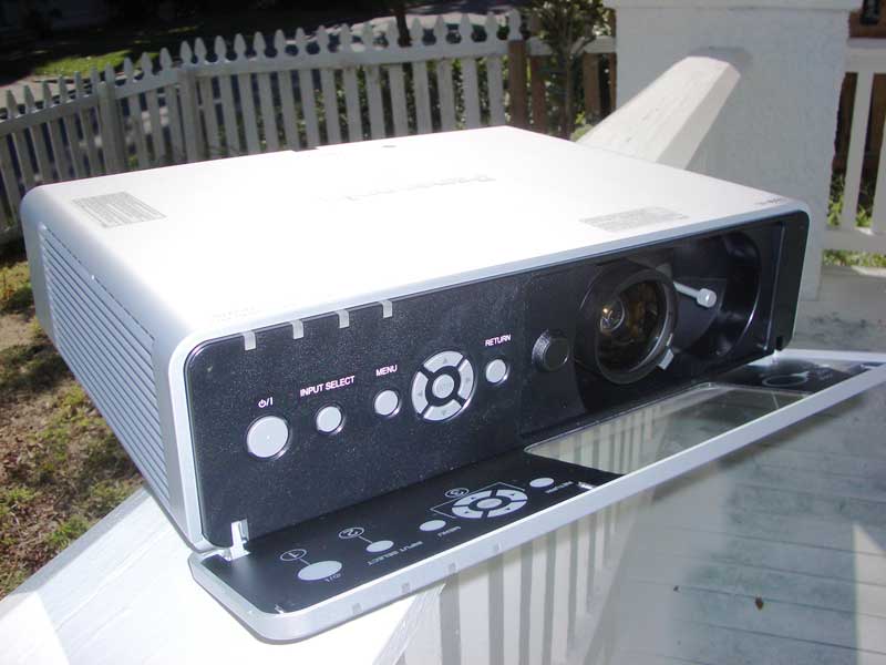

PT-F100U-angled3.jpgPhysically-speaking, the front panel on the projector flips down and reveals access to the lens shift, manual zoom and focus functions as well as power and the Menu controls. This is a nice feature as it gives the unit an extra level of security (though the front panel doesn't have a locking feature) and keeps dust from accessing the front of the lens. It's also a beautiful way to streamline the unit and make it look like a very sleek box.
