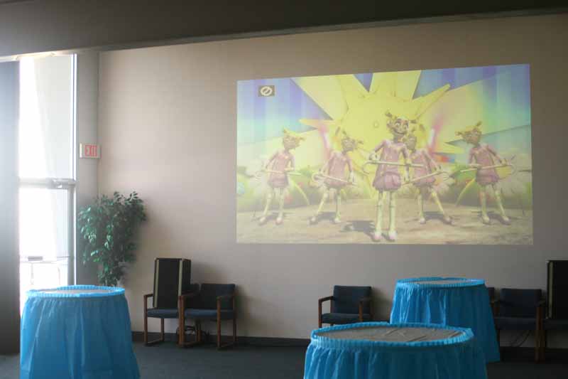

The Florida event featured independent film videos from all over, and a couple of them were beautiful animated films that just amazed us - especially given the fully-lit room:
Don't try this at home with your puny 1600 lumen projector!
As mentioned, we started off with the projector in Dynamic Mode which activated both lamps and set a high color temperature for maximum light output. In the photo above you can see that we got an insane amount of light output even in the midst of a fully lit room. This isn't how we'd recommend you use a projector like this, but it was great to see that it would work for us even before the sun went down.

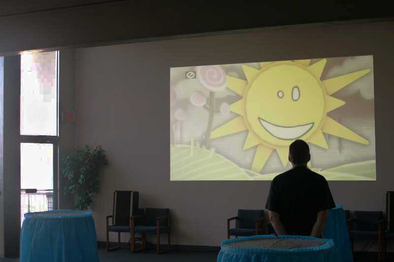

As the night went on we saw better and better picture and were eventually able to put the projector into its optimal single-lamp Cinema Mode:
