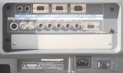

  • Terminals: BNC
  • VIDEO IN: BNC
  • VIDEO OUT: BNC
  • S-Video IN: Mini DIN 4-pin
  • RGB1/YPBPR IN: BNC x 5
  • RGB2 IN: D-sub HD15-pin
  • Optional board slot: Yes (1)
  • RS-232C/422 IN: D-sub 9-pin female
  • RS-232C/422 OUT: D-sub 9-pin male

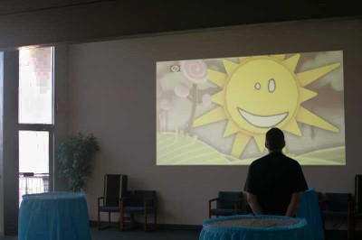

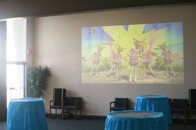

  • Extremely flexible lens options
  • Ultra bright output for larger screens
  • Dual lamp system allows for excellent black levels
  • Expandable inputs via optional board
