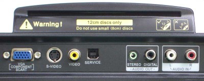

Connections
On the back of the DV11 you will find a few different AV inputs and some audio outputs. Composite and S-video connections are present for feeding an external standard definition source to the projector with stereo analogue audio inputs for sound. Though on initial glance there seems to be no component video inputs, the VGA connection can support YPbPr and an adapter is included in the packaging. HDMI is not supported, so you won't have a direct digital AV connection to the player. There is a digital audio S/PDIF output - something you don't see on many projectors. This is simply to ensure that you can get audio out from the on-board DVD player and route it into an existing home theater system. Most AV receivers manufactured in the past 5 years will support Dolby Digital output via this coax digital (S/PDIF) connection. As part of your quick set-up tear-down you can grab a 12-foot coax cable and have it ready to pull out for use with this system. For anyone using an HTPC (home theater PC) an 1/8-inch mini audio output is also provided.
Taking a look above the inputs and outputs you'll see the new slot-loading integrated DVD player. This is a pretty nice feature and gives the DV11 a much slicker look and feel over the DV10. A USB "Service" port is not usable by consumers and is apparently for updates and diagnostics at a dealer repair facility or the manufacturer.
