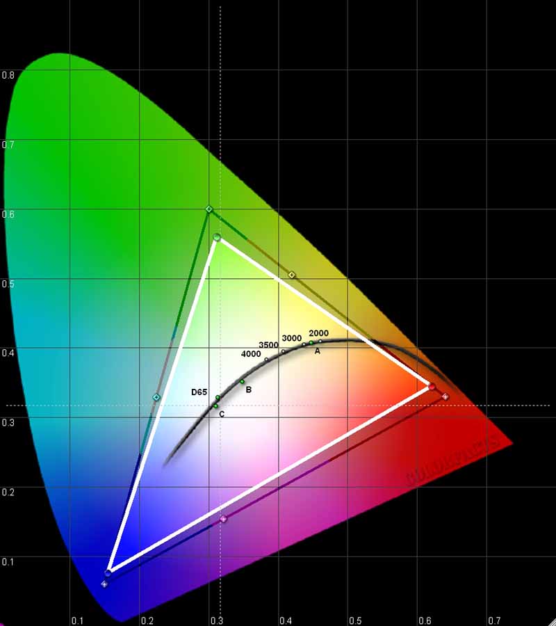

DV11-CIE.jpgI do not recommend calibrating this projector. Frankly, it didn't seem to need it. With the measurements we took, once we selected the correct settings, the performance was on par with what we'd want to see in our particular viewing room. If there was a deficiency it would have to be that it had a slight saturation loss for both green and red. We have seen a LOT worse, so it didn't particularly bother us.

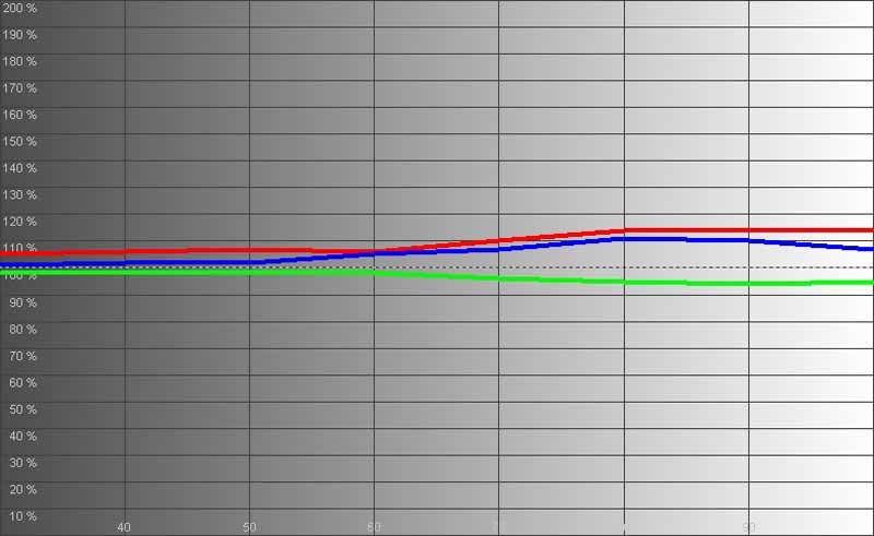

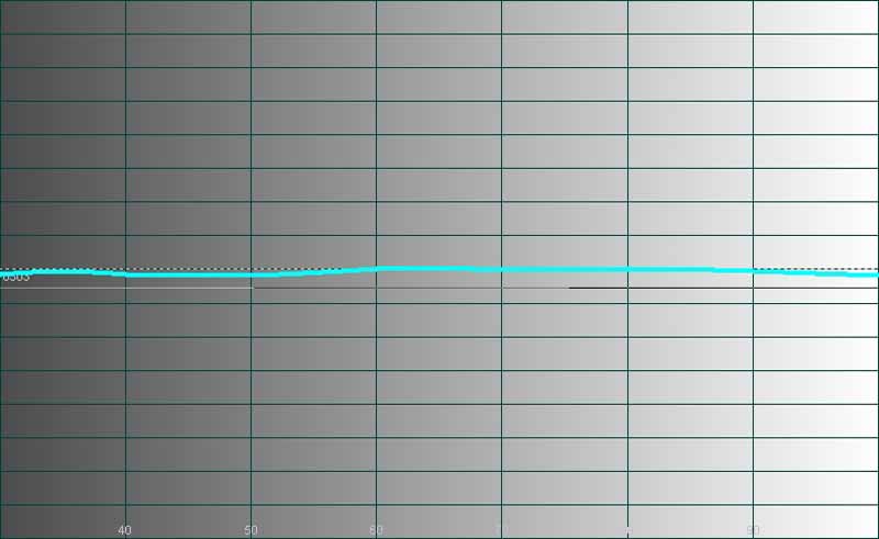

We utilized datacolor’s ColorFacts Professional 6.0 software to calibrate and measure the grayscale response of the DV11. What we found was that the initial Color Temp settings were not perfect, but once we selected '0' (instead of the default '1') everything snapped into place.

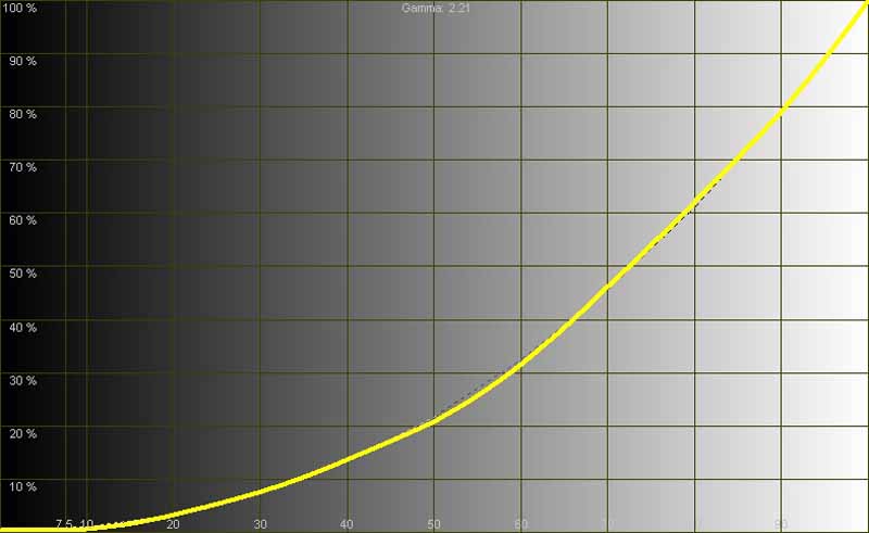

Here you see that we measured a not-bad-at-all grayscale from 30 to 80 IRE. Color temperature was excellent once we adjusted the setting and was more linear than many more expensive displays I've encountered this year. The Gamma measurement came in at 2.21 - which is about perfect, unless you prefer a slightly brighter picture.
