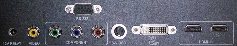

Taking a look at the rear of the HD80, you'll quickly find that all the inputs and features you're likely to need or want are there. Dual HDMI inputs as well as component and DVI-I mean that only the most ridiculous configurations are going to have trouble piping signals into this display. A 12V trigger output and RS-232C port means that custom installers have the tools they need to integrate this projector into more complex control systems. The only port missing from the HD80 is an HD15 (RGB) port for PC use and the DVI-I takes care of that since it supports analogue VGA-style signals through its input. This is one well-equipped projector.
