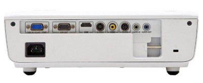

I/O Connectors HDMI, VGA-In, S-Video, Composite Video, Stereo Audio-In and RS-232

- Auto-source sometimes doesn't give enough time for HDCP
- No component input or breakout box
