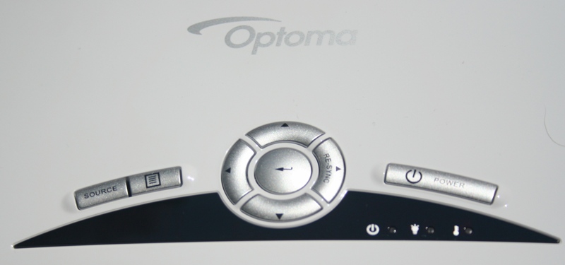

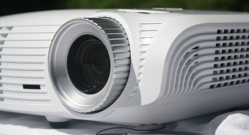

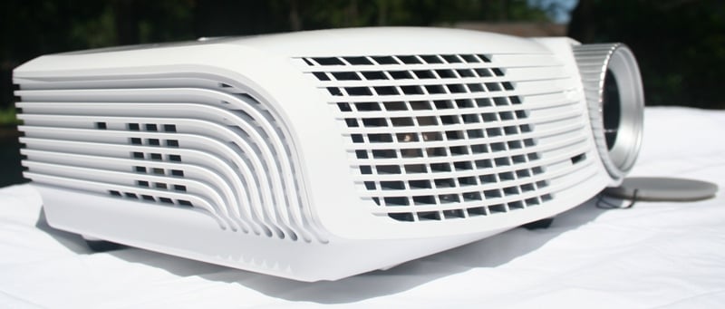

HD20 angled1The Optoma HD20 arrived in good working order in a dedicated box with air filled packing protection. The Optoma HD20 is white, has a lens cover, security bar (for locking the projector), and top controls. The body is constructed out of white plastic with grey highlights. The lens is mounted on the right (if the projector is upright and you are facing it) with a series of vents on the other side. The unit feels well-built and sturdy. The top of the unit has everything you need to control the HD20 if you lose the remote or if you have it table mounted. There are dedicated source, power, and menu buttons along with directional controls for accessing and navigating the menus. Near the lens there is a 1.2:1 manual zoom control.

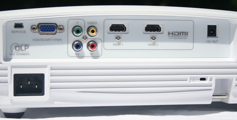

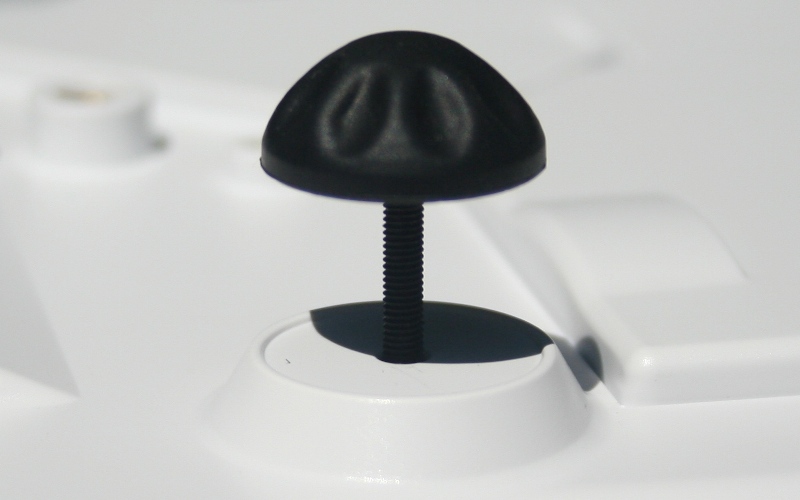

The back of the unit sports a VGA input for computers/HTPCs, composite and component video, and two HDMI inputs. At this price point, that seems about right. There is a USB service port as well as a 12-volt trigger for controlling a screen - a great feature at this price point. The bottom has three adjustable feet for leveling.

HD20 top controlsThe most important menu is Image with all the normal top level display controls like Brightness, Color, Contrast, Sharpness, etc. We recommend immediately switching the HD20 into Cinema mode and reducing the Sharpness as low as it will go. Depending on your ambient light, source device, and other considerations, your Brightness, Contrast, etc. settings will vary. We found that between different models of DVD players we got very different settings.

There is quite a bit of light leakage from the front of the HD20 but the grills keep it pointed away from the screen. While my 4 month old son loved to look at it, this is generally undesirable. Our room is painted a dark color so we never noticed any negative effects in the room from the light. In addition the HD20 is also a louder projector than we'd like to see. While it is a good bit quieter than your typical business projector, like the InFocus IN3108 we just reviewed, it is still louder than we want to see in a Home Theater projector. While it wasn't a problem during most viewing, quiet passages were definitely interrupted by the noise.
