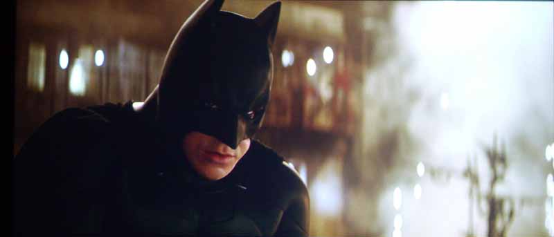

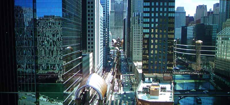

HD DVD - Batman Begins
batman-begins.jpgThis movie was dark… and detailed… and absolutely reference quality. I loved the plot, but I loved watching the natural torture tests shown on-screen even more. Whether it was pin-striped shirts, or city skylines that would make any jaggie-reduction scream in terror, Batman Begins is a movie that you can test nearly all aspects of a projector's video processing system with. I also like the fact that you can enjoy your time while doing it. There are test scenes that are absolutely horrendous to sit through - this movie makes it fun and easy. I cautiously watched through the darkest scenes (nearly the whole movie in fact) and tried to pick out loss of detail, crushed blacks or banding, but found none. Everything came through impeccably and with the sort of naturalness that gave the images rendered by the HC5000 a clarity and depth I don't see all the time.
I could post about 10 more shots of the film, but I'll cover that in my HD DVD review of the movie which will be published shortly after this review.

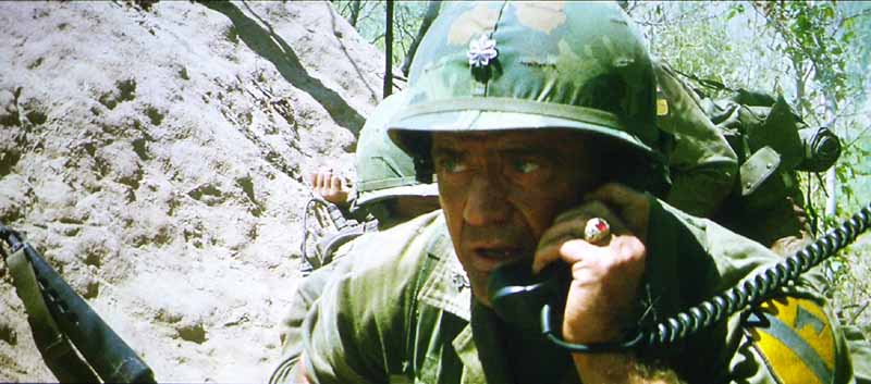

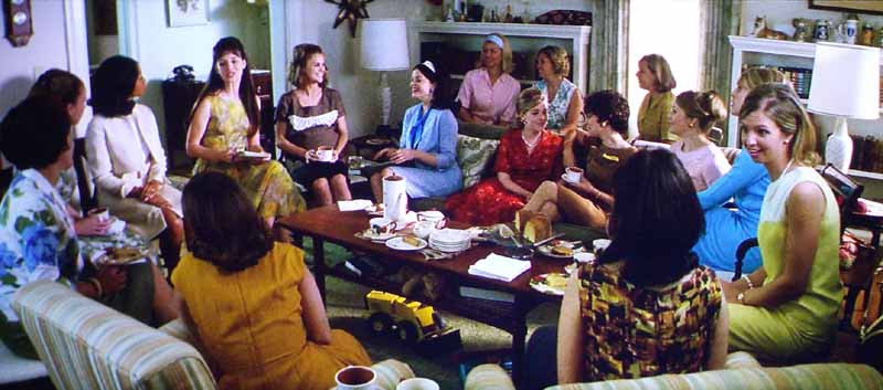

we-were-soldiers.jpgI can't believe I missed this movie on initial release, but somehow I did. Mel Gibson and Randall Wallace (Braveheart) teamed up to bring another epic title to the screen - and pulled it off with gusto. This movie had a lot of detail mixed with extremely fast-paced action. Due to the quality of the film, motion adaptive noise reduction played a major roll here and the Mitsubishi didn't drop the ball. The interesting picture also juxtaposed colorful breakaway sequences of the family life the soldiers left behind and broke up the more earthy color sequences that dominated the Vietnam battlefield. I loved looking around the scenes as they went by, checking out the details in the earth and rocks as well as the equipment, outfits and helicopters. It's a great movie, and though I would hardly call it reference quality, it made for an excellent test-bed of the HC5000's capabilities.

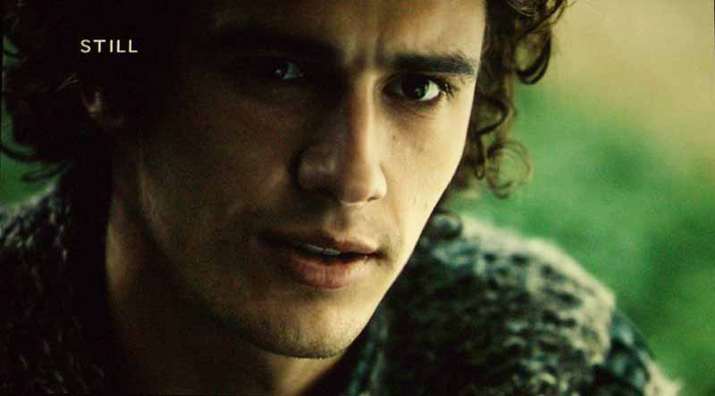

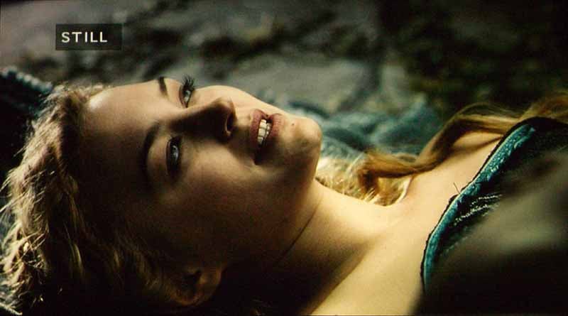

DVD - Tristan & Isolde
tristan-isolde.jpgMy wife picked out this movie and I was hesitant at the title until I read a bit more about it. When it played out on screen I was amazed at how good a movie could be that essentially blended the stories of Romeo and Juliet with that of Guinevere and Lancelot (I highly recommend you read The Once and Future King by T.H. White). In short, the story is excellent and the cast was brilliant. As for the picture, it was pretty good - especially with regards to close-ups of faces and garments (which were all hand-made to exquisite detail on-set). Because this movie had a lower budget, the photography was a bit bland in terms of color, so this wasn't a great film for stretching the depth of saturation the HC5000 is capable of delivering. For detail and black level, however, Tristan and Isolde was a great piece of test material. James Franco is definitely on the upswing of his career.

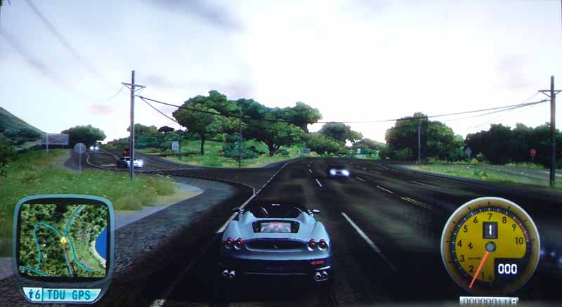

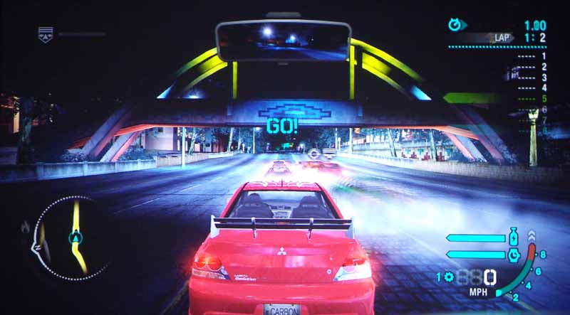

Xbox 360 at 1080i: Various Games
Between movies and my Xbox 360, I can say that I really enjoyed using the HC5000 projector. Games in particular (the Audioholics crew gets together every Wednesday night for some online playing) looked fantastic on this display and sitting just over 11 feet away from a 100-inch screen while playing Halo2, driving a $200,000+ Ferrari or picking off rogue South American dissidents is something not to be missed.
