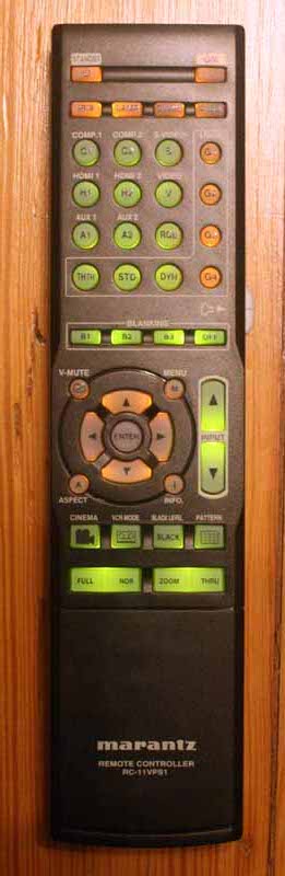

remote.jpgI really like the remote supplied with the Marantz VP-15S1. Aptly named the RC-11VPS1, this is a fully backlit remote with direct access to all primary functions, including Input selection and video modes. After initial calibration it would be unlikely you'd ever need to actually enter the Menu system to make any adjustments since the remote gives you direct control over Blanking, Black Level, Aspect Ratio and even Iris, Color Temperature, Gamma and Lamp control. The backlight function isn't automatic, but an easily accessible side switch puts the light on for 10 seconds at a time. In addition to simply providing backlighting, the remote actually separates various areas of the remote by utilizing both green and amber coloring. There are four User/Gamma modes (only the first three buttons work and they toggle up to 9 settings overall) which allow you to store custom Picture Modes. With these modes you can literally customize Picture settings until you have one for every day of the week… and then a couple more.

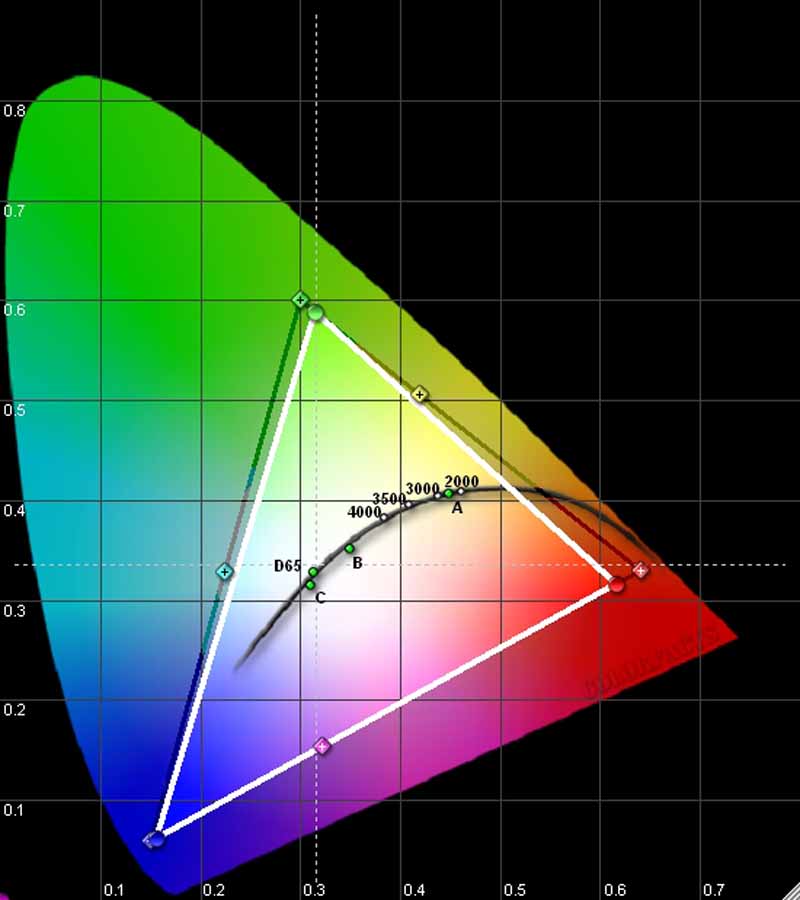

VP-15S1-CIE.jpgWe took some before measurements after resetting the projector to its Factory defaults. We then calibrated the system and compared the end results to the original. For calibration we utilized datacolor's ColorFacts Professional software with a Spyder2 sensor (tristimulus colorimeter). I have to say, this was one of those projectors that really only needed to be set to the correct menu configuration. Calibration was not something that dramatically improved the already excellent picture.

Now, the default Theater 1 mode ran the projector with the lamp set to normal. With the Iris set to 1 and the lamp on Economy color temperature jumped to 5800. Select Color Temp 2 in the menu system and the results fall in line at 6400K. With that said, we recommend Theater 1 mode with an Iris level of 1 and Color Temp set to '2' for your default theater mode. This will give you excellent color as well as the deepest Black levels this projector is capable of delivering. The color reproduction of this projector is nothing short of brilliant for HD signals per our CIE chart which displayed our RGB measurements.
