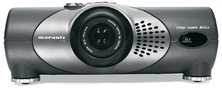

Marantz VP-15S1 front
The remote is fully backlit, and has access to most of the controls you'll ever require or desire. Direct access to inputs is available - for all inputs and there are even discrete On and Off buttons for powering up and down the unit. The Marantz VP-15S1 video projector, which joins Marantz’ other True View projectors (VP8600 and VP-11S1) is now available and retails at a price point of $9,999. Ouch, that's a lot of clams, but Marantz is not known for putting forth anything but high end and we can't wait to get our hands (and eyes) on the custom optics to see just how rich and clear the picture on this projector is.

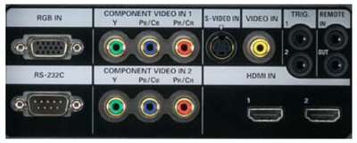

Marantz VP-15S1 inputs

I don't think that Radio Shack was responding to us when they started selling this: Model number 26-152 (I tried to post the link, but this system won't let me post links yet), but it is a 6' female to female straight through serial cable.
There are cables made for about all types of pinouts, and I'm not saying things to be a jerk, but because most CE manufacturers simply choose to ignore industry standards.
Seriously, you talk about "should be" and "standards" where there aren't any. There are "conventions" but even then they are all over the board. If you talk to the engineers at Crestron (arguably they know more about this than most of us-- also we are the interntaional distribution point for their products), they will agree that products are all over the board. This is why most installers just wire their own cables the way they need.
This is not correct. There are standards, and they are used by every single computer manufacturer in the world, as well as Crestron.
EIA-574 standard, as shown here:
http://www.arcelect.com/rs232.htm [arcelect.com]
Your competition, including Barco and Clarity as well as a long list of others utilize input and output RS-232 DB9 connections which follow industry standard: Input = DB9F TX2, RX3, Gnd5 - Output DB9M RX2, RX3, Gnd5
When 100% of PCs follow this standard, Crestron follows this standard, and your competition follows this standard, I would say that you are incorrect when you say that there is no standard.
It is more accurate to say that much of the industry doesn't care enough to actually understand the standards in place to follow through with them on their products.
You should know that in the world of consumer AV and custom installation, we are one of the most highly regarded to work with. We were the first to the game with all discrete IR codes, DC triggers and more. We are one of the few that includes not only direct flasher inputs, but IR receiver inputs which can directly power a separate IR system with no connecting block necessary. And if you are to believe Crestron, we have one of the best 232 protocols in the industry.
So is it cocky, or is there room for improvement? Seriously, step back because I'm not going off on it as a bunch of crap product. It really bugs me when the rhetoric from companies emphasizes how great they are instead of recognizing areas they could actually improve upon.
