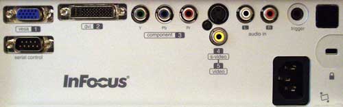

There are quite a few input options for the ScreenPlay 5000. It features M1, HD15 (VESA), component, composite and s-video connections. I would recommend this unit be used with either an M1 to HDMI/DVI adapter (not included) or the component video inputs. Of course if you are using this projector as a presentation device then the HD15 inputs are just fine. The M1 input is HDCP-compatible, however I hope this is the last ScreenPlay model InFocus sells that does not include at least one of the adapters. In this day and age it is inconceivable to let a projector out to market without direct HDMI or DVI input capability.
We utilized the component video inputs for our tests. We tried both interlaced and progressive source signals to check the deinterlacing ability of the ScreenPlay 5000. Our results are shown in the Viewing Evaluation setup
