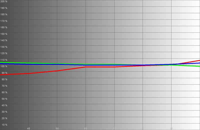

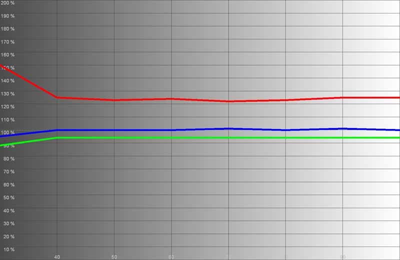

We utilized datacolor’s ColorFacts Professional 6.0 software to do our calibrations and measure the color, contrast and grayscale response of the IN78. Starting positions were a bit off what we expect to see in a high-end projector, but calibration proved successful for the most part as we quickly dialed in the HD81 to approach ISF levels. For the ‘before’ measurements, Auto Iris was engaged and the settings were configured for best film response in a light-controlled room.
Before Calibration |
After Calibration |
Even though we set the projector to 7500K mode to get closer to D65, we still saw quite a bit of warmth in the picture which was spelled out by our initial RGB measurement. |
After calibration we got a much tighter picture, though I was surprised by the drift found in the lower IRE spectrum. |

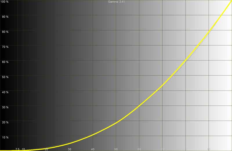

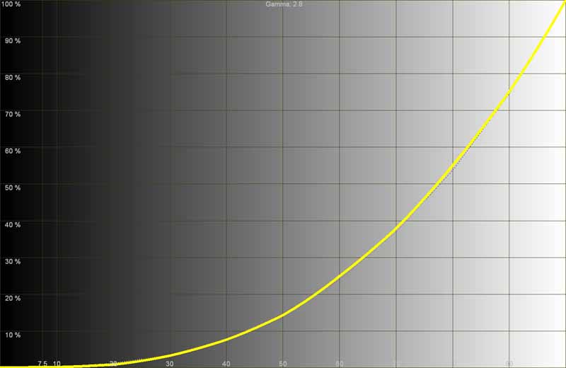

Initial gamma was 2.8 in "CRT" mode We flipped it to Film before calibrating the system. |
Our final measurement got gamma to 2.41. |

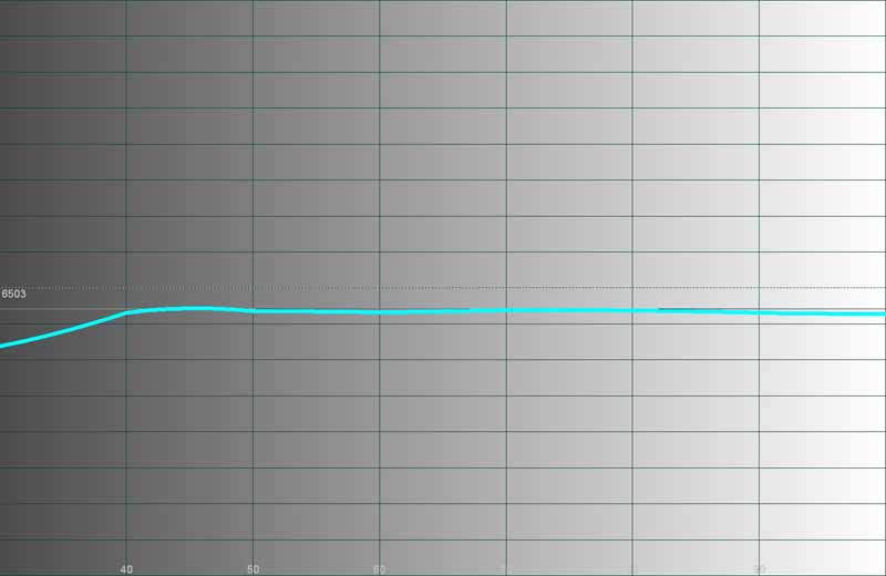

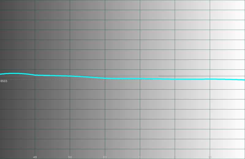

As you can see, initial color temperature was around 6000K even with the projector set to 7500K. |
After calibration, we saw a much better response, with the bottom IREs matching the apparent red boost we couldn't quite get down. |
