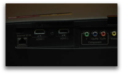

  • Inputs: 1 composite, 3 component, 1 VGA D-sub 15 pin, 2 HDMI, 1 RS-232C
  • 12VDC Trigger On/Off (3.5 mm stereo jack)
  • RJ-45 (for external 3D IR emitter)
