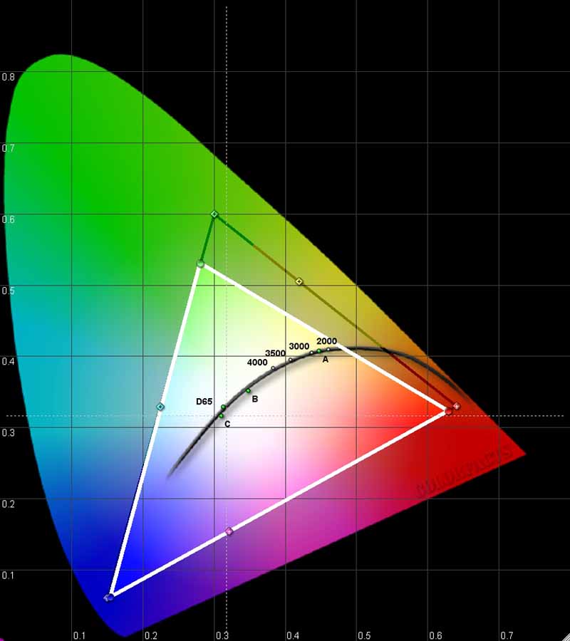

The default settings of the 1080UB were satisfactory once Black and White levels were configured properly. As mentioned above, setting the correct black and white levels required that we engage HDMI Expanded mode so that below black signals - permitted and often present on DVD masters - were shown. Of course, once we saw that below black was received, we dialed down the Brightness (-11) and brought up the Contrast (+12) until the levels were correct and the best dynamic range possible was shown. Color reproduction of the 1080 and 1080UB were similar in that the green was out - however, for whatever reason, the green leaned towards yellow on the 1080, and it leaned towards blue on the 1080UB:
Epson Pro Cinema 1080 (left) and 1080UB (right)

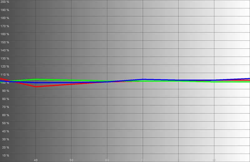

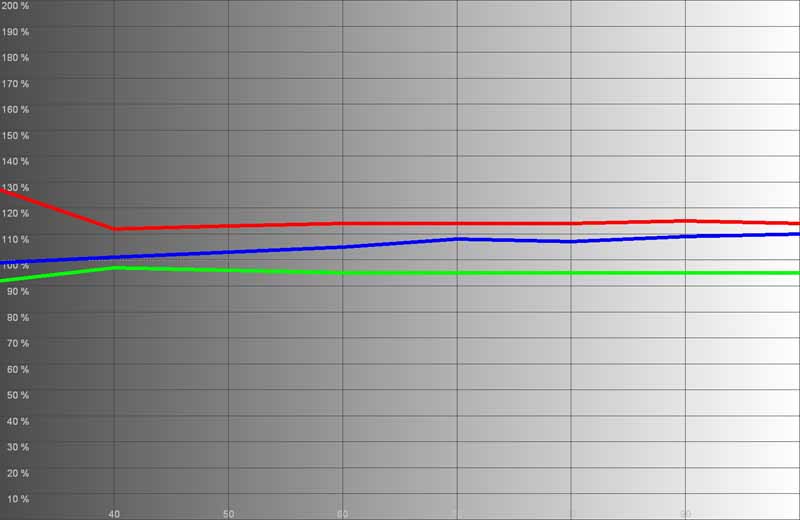

RGB levels before (left) and after (right) calibration

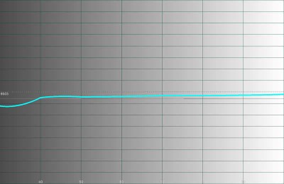

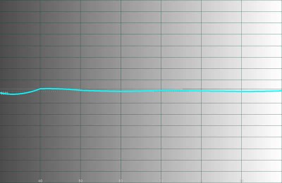

Color Temperature before...
...and after calibration
