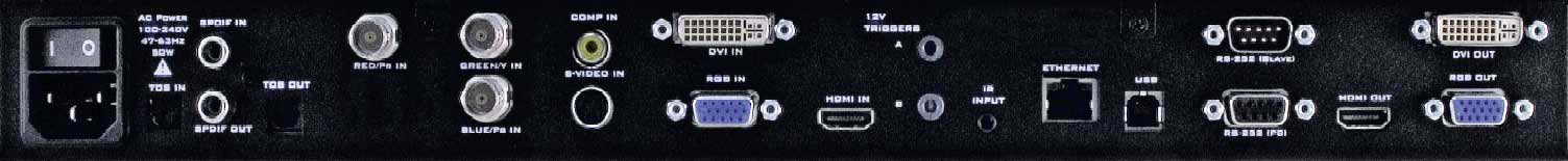

Connections
I actually would like more connections, but then again with modern AV processors and receivers, perhaps the 1 rack space TX3 is all you need. In any case, composite, s-video, component, DVI-D and HDMI are all accounted for and will ensure that whatever source you are sending to the display - it can be entered into the TX3. The argument for additional inputs would be mostly limited to HDMI. In this way, you could connect a PlayStaion3, Digital Cable box, DVD player and even a HD-DVD player to your processor without the use of a switcher (or more importantly, going though any additional video processing before the signal gets to the HQV processor). As it stands now, this $3000 processor may require the use of a separate HDMI switcher or the use of a modern AV processor or receiver. Taking a look at both units, wee can see the available inputs:

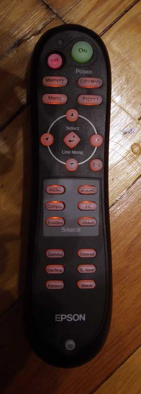

Epson Pro Cinema 810 Remote Control
The Epson remote is rather bulky, though it makes the effort to appear
curvaceous and conform to the user's hand. It fails at this, but it does excel
at several points. First, the Pro Cinema 810 and remote have the best IR
transceiver/receiver system on the planet. The IR control system designers are
at Epson should be licensed out to every other manufacturer on the planet
(especially the new entry-level display companies) and take the industry to
school on how to make remotes communicate to devices. You can just about point
the remote anywhere and it will control the unit. In fact, I was actually
trying very hard to PREVENT the remote from controlling the Epson and I failed
miserably most of the time unless I physically block the IR receiver with my
entire hand (a finger wasn't enough). Pointing the remote at the screen works
wonderfully (bouncing it back to the projector) and you can do just about
anything you want and still retain IR control.
Aside form the bulkiness, the remote has some other positive and negative features in my opinion. The presence of direct input selection buttons is always a plus - as are the discrete power controls. You have access to just about every major function on the projector that would be needed on the fly, including Memory settings, Color Mode, Aspect ratio and even some you don't - like Color Temp, Gamma, Skin Tone and Pattern.
I would love for the backlight button to either be located on the side of the remote or in a state where it could be configured to come on with any button press. As with all projector remotes, the buttons should light up all the time when pushed - after all, this is a home theater projector and it's going to be used in varying levels of darkness. Overall this is a good remote and will be easily programmable into either consumer universal remote controls or a more robust system.

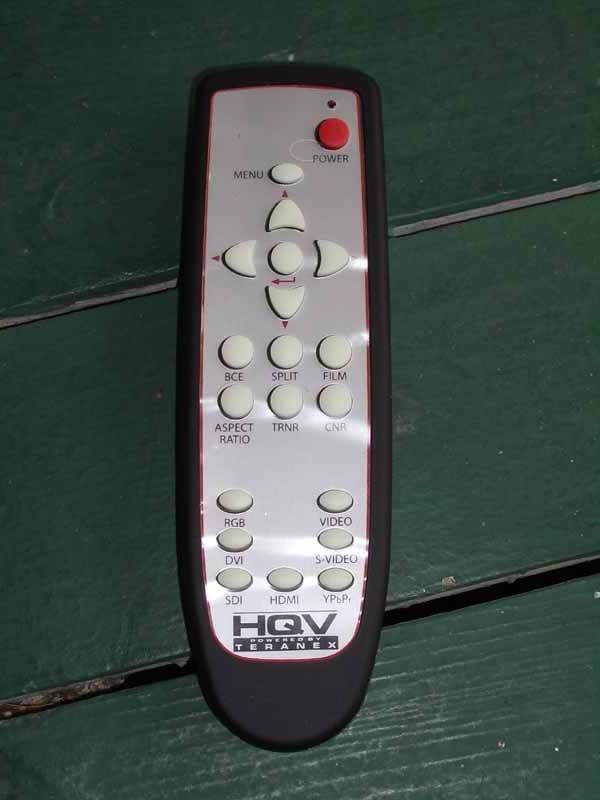

Silicon Optix HQV TX3 Remote Control
The HQV TX3 remote control made the
Epson look even better. Resembling the Westinghouse LVM display series remotes
(same Chinese manufacturer), the TX 3 doesn't even sport a discrete on/off switch or any backlighting to speak
of. The buttons do glow in the dark,
however making this remote suitable for use in any cereal box giveaway.
The remote is separated into three main sections - navigation, source selection and HQV features and controls. These HQV onboard controls include some of the more detailed HQV settings like Film mode and Aspect Ratio. Codec Noise Reduction (CNR), Temporal Recursive Noise Reduction (TRNR), and a split function are also included. Split allows you to compare the noise reduction using a split screen where only half the image is processed. There is also a direct button for Brightness/Contrast Enhancement (BCE) which is essentially a form of Picture Mode for using the projector in Day or Nighttime situations.
Its IR functionality was fine and it got the job done, but for the price of the processor I'm guessing Silicon Optix supposed no one in their right mind would be using this remote for very long - and they are probably right.
