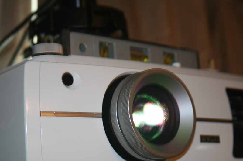

level projectorWe mounted the Epson 8100 to our Peerless PRG-UNV Precision Gear universal projector mount using its four screw anchor points. I like that this projector has four mounting points. All projectors should, though it often seems like the heaviest ones are the ones that choose to go with just three – go figure. We again leveled the projector by using a simple torpedo level which we placed atop the projector to square it to the screen and apply the manual Zoom and Focus. The 8100 had the same Fujinon 2.1:1 lens that exists across the entire lineup and it produced a flawless 92-inch picture on our Carada Masquerade masking projector screen. Since the Epson has a 96% vertical and 47% horizontal lens shift, you can place it just about anywhere and hit a screen without having to resort to keystoning (which is good, because the 8100 doesn't have any).

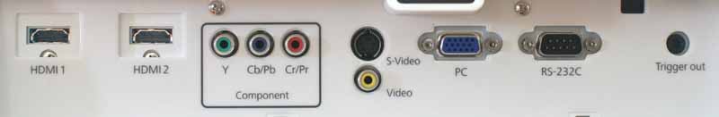

The Epson Home Cinema 8100 projector has enough inputs to meet almost anyone's needs. Though you'll likely only use one, there are two HDMI inputs and a single component video (YpbPr) input, plus a composite and S-video input for legacy sources. It's nice to know that you don't need to step up to the Pro Cinema line to get RS-232 control and if you want, you can connect any PC to this projector and send it screen resolutions up to 1920x1080.
8100 inputs

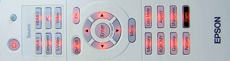

The remote control is unchanged and features the same, easy-to-use backlit functionality as prior models. This remote is excellent and delivers direct access to each of the projector's six inputs. You also continue to have direct access to such functions as Aspect (ratio), Memory, and Color Mode – which is nice for on-the-fly changes. The backlight is activated by a small button on the top right of the remote and remains on for approximately 10 seconds after the last button press.
8100 remote
This remote is backlit perfectly and easy to use in the dark
