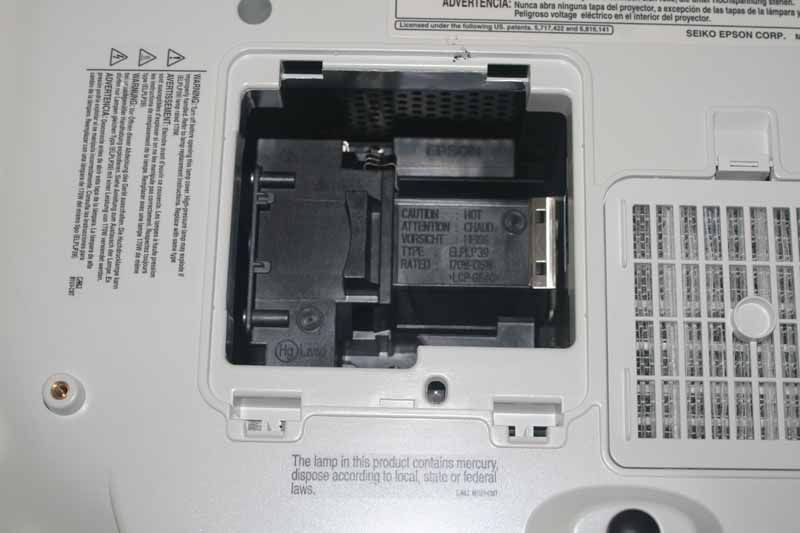

HC-720-lamp.jpgLet's pop the hood. Underneath the Epson you can find easy access to the lamp replacement compartment. While the lid comes off without any screws, its location means that you'll need to remove it from any ceiling mount before you can replace the bulb. We prefer rear- or side-entry locations for bulbs, but this isn't the end of the world. The two front feet screw down for angling the projector upwards from a tabletop location. Epson didn't include a "quick drop" mechanism, so you simply unscrew… and unscrew… and unscrew… until the height is correct. Obviously, the better installs for this projector will have the unit on a level platform so that the lens shift, and not manual or digital keystoning, will be sufficient to hit the screen perfectly.
