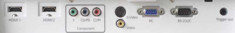

Terminal Inputs:
2 HDMI 1.3
Composite video: 1 RCA
Component: 1x3 RCA
S-video: 1 Mini DIN
Analog RGB: 1 D-Sub 15 pin
RS-232c: 1 D-Sub 9 pin
Terminal Outputs:
2 HDMI 1.3a
HDTV
Component video
S-video
Composite video
NTSC/ PAL/ SECAM
Analog RGB (PC only)

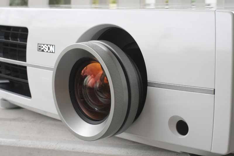

Picture quality is really helped, not only by the video processing done by the implementation of Epson's FineFrame frame interpolation circuitry, but also by the physical use of a Fujinon OptiCinema lens with 2.1 zoom ratio. Brightness is more than adequate with 1600 lumens - that typically ends up around 1000 or so after calibration, and a new anamorphic lens mode enables 2.35:1 anamorphic viewing without an external processor. This feature alone is worth the price of admission - as it means that you no longer have to buy a separate lens system in order to enjoy full-pixel implementation of 2.35:1 content on your projector. As an added bonus, you can also use it to vertically stretch 4:3 aspect ratio source material to optically fit a 16:9 space. You'll lose information at the top and bottom, but it's a nice option to have and we use it on older TV shows we happen to have on DVD or non-HD television and movies.
Configuration and setting the projector is easy as always, since Epson has a manual lens shift of 96.3 percent maximum vertical and 47.1 percent maximum horizontal. Inputs are plenty, with two HDMI 1.3 connections (with Deep Color support) and, of course, component video - which we use extensively for delay-free gaming.
8700UB connections

8700UB lens
