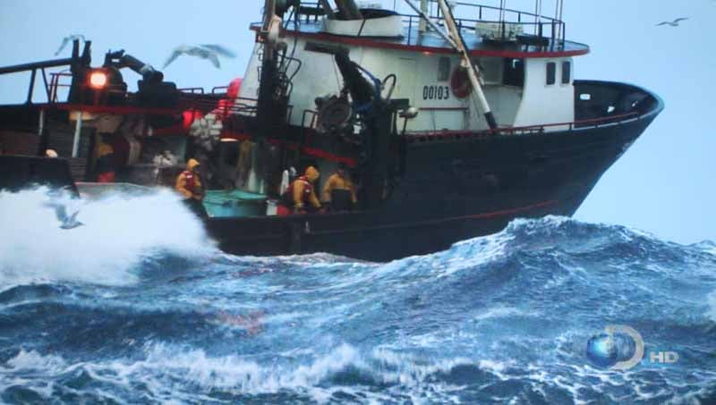

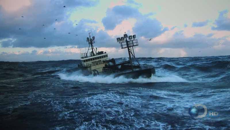

HDTV: Deadliest Catch
This is a great show on Discovery HD Theater, made even greater opportunities to see how well your display stacks up against nighttime hi-def shots, rolling waves, and a lot of fast pans with complex source material. Ever want to see how well your front projector will follow a king crab flying across the screen into an ice-soaked ship deck? OK, maybe I'm weird... Still, it looked really great on the W5000.
The colors in this show really come out in the sky and the outfits worn by crew members as they struggle to survive the brutal conditions associated with fishing the Bering Sea.

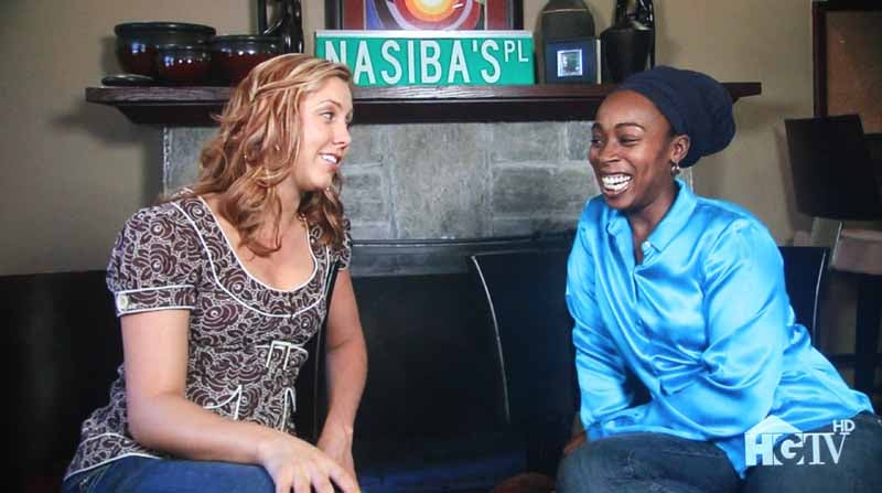

HDTV: My House is Worth What?

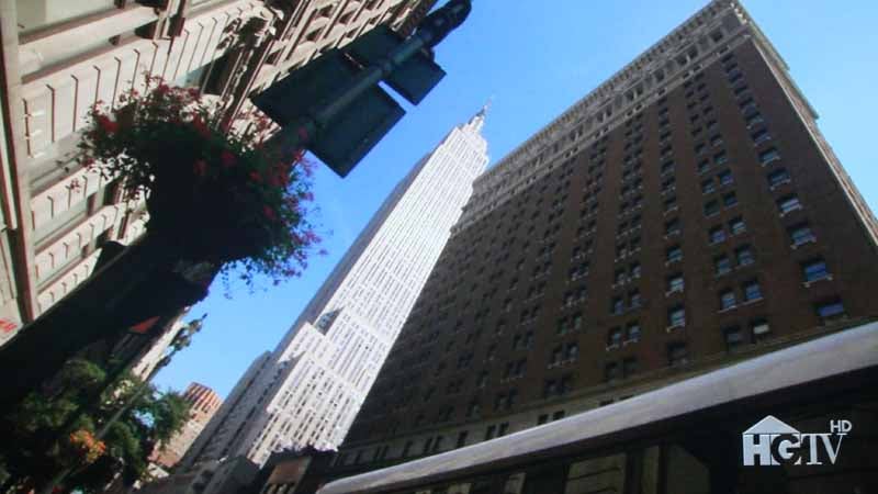

This show is filmed with high quality HD cameras and utilizes ample lighting. The result is a crisp, clean image that is hard to beat. Colors pop, edges are crisp and the content does well to show off any projector's ability to render crisp detail. In this particular episode, an establishing shot of the city resulted in a real-world deinterlacing test which the W5000 passed with flying colors.
Look at the buildings here. At 1080i and in motion, this presented a great challenge.

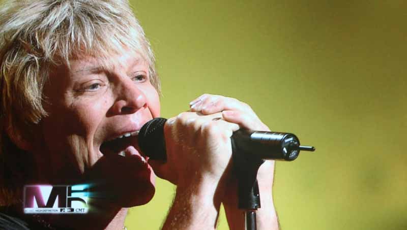

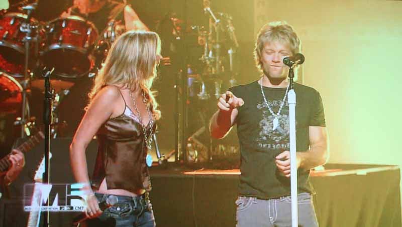

HDTV: MTVHD Bon Jovi Live Concert
We got a chance to see some Bon Jovi in high definition courtesy of MTV's new HD channel. It was well worth our time and the images we captured, while they can't possibly do justice to what we saw, are at least representative of the excellent material we viewed.

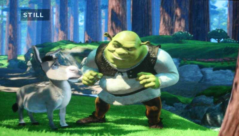

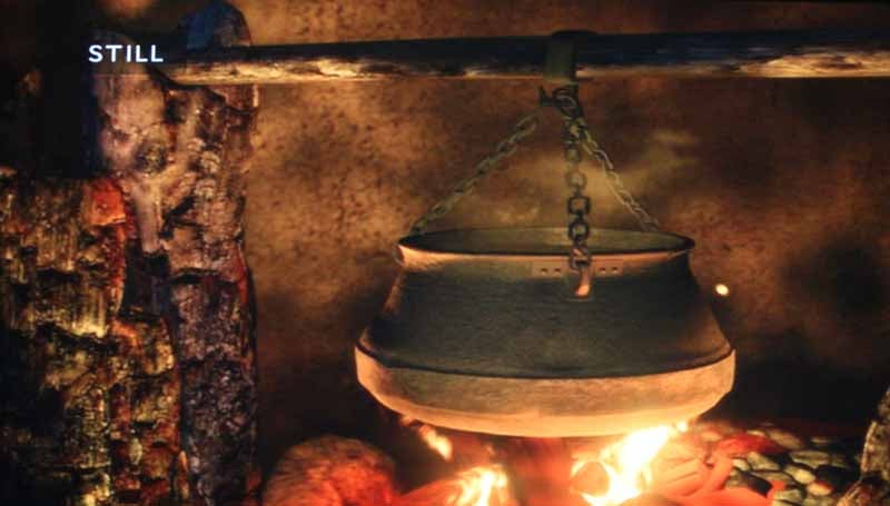

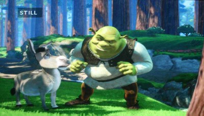

DVD: Shrek
An oldie, but goodie, I wanted to put something up which showed the excellent film-like color reproduction possible with the W5000. Shrek seemed like a perfect movie to use and we also got to see more of how well the BenQ projector handles SD content upconverted to its natural 1080p resolution.
Colors popped but maintained a film quality provided Brilliant Color was left off
Brilliant animation moments like this delivered shadow detail and opportunities to see (a lack of) banding in difficult areas of images such as fire on a kettle.
