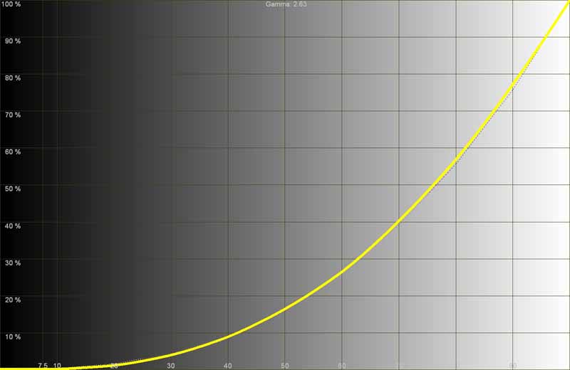

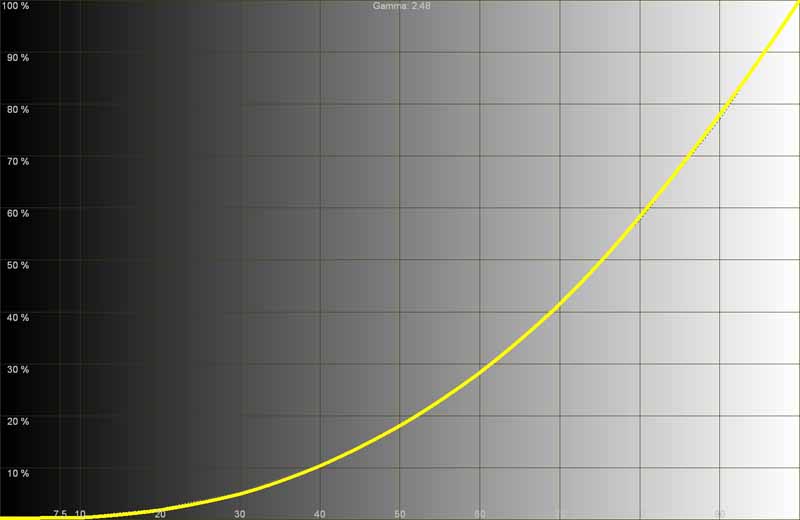

Final Gamma (right) was
between 2.4-2.5, a slight but marked improvement over the original 2.6 (left)

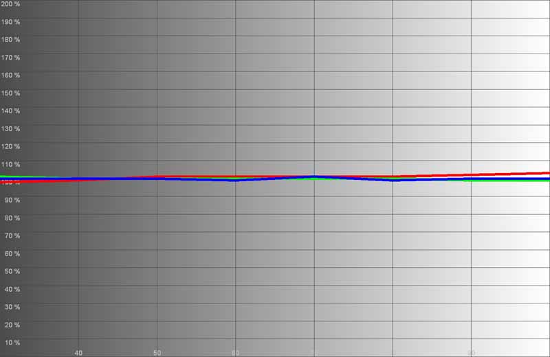

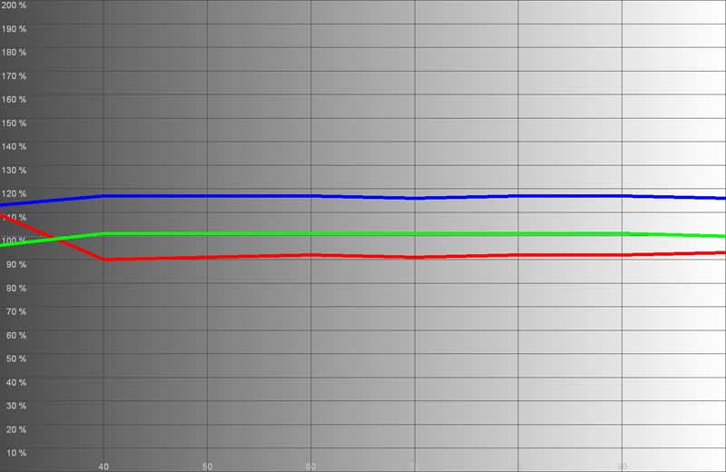

The grayscale,
initially dominated by blue (left), ended up nice and smooth after our
calibration (right)

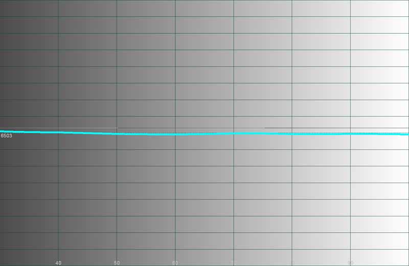

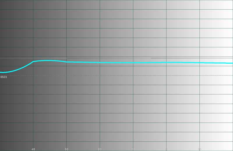

Color temperature
dropped from its initial 7500K (left) to an almost spot-on 6500K across the board
(right)
