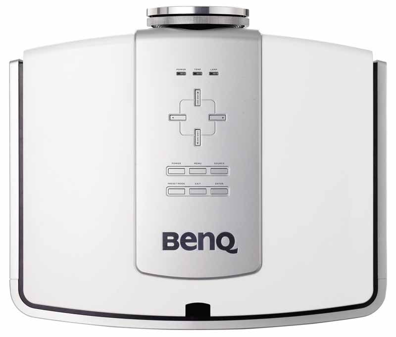

W5000-top.jpgPhysically, the W5000 is an impressive projector. While not exactly elegant, it is a true machine. From my first glance at its exterior I had to pop my eyes back in their sockets when I saw the enormously deceptive size of the lens hood. The W5000 exudes high build quality, from its looks, to the 21 pound weight and convenient side-entry lamp replacement.
The top of the projector houses a real slick-looking control panel for menu, power, and source controls. You can also activate lens shift functions and toggle through presets. Three small lamps give you a quick overview of power, temperature and lamp status (you really only want to see one light on.) The enclosure itself is a beautiful mix of white and silver with some black trim thrown in for good measure. I'd easily cast my vote for having this thing show up as a small Decepticon in next year's Transformers 2 movie. Lamp access is via the left side (no need to remove the projector from its mounted position) and the filter can be replaced easily from the right side of the unit. Unlike most projectors I've seen, all four feet are adjustable. If you're not mounting this to a ceiling or other permanent fixture, however I think you'd be doing yourself a disservice.

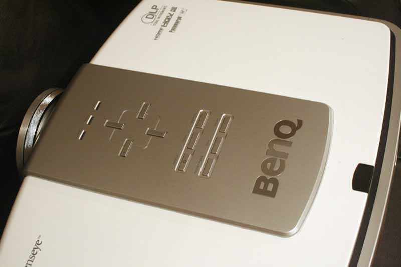

W5000-top-angle.jpgBenQ seems to have spared no expense in equipping the W5000 with a slew of handy features. Some I found useful, but all are very handy in terms of their ability to allow this projector to dial in a nice picture and work well in a myriad of installation scenarios. While DLP has a lot of catching up to do when it comes to lens shift, the W5000 at least provides vertical shifting of the optical system. This means that you have some height flexibility when mounting the system in a front or rear projection scenario. The W5000 allows up to +120% and -80% adjustments, giving you a wide range of placement options. Horizontal shifting is unavailable - so you'll really have to nail your location or ensure that your screen can be shifted slightly to get the perfect projected image.

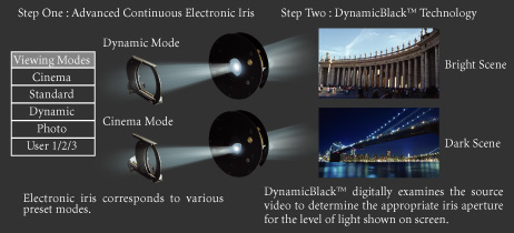

Other hardware advances include a dual iris system. This is cool, and it's rather complex. I personally like it because it allows me to get better black level output when high lumen output isn't so important. Then, once I choose my fixed Iris position, the Dynamic Black electronic iris kicks in and further refines the image on screen. Here's BenQ's graphical representation of how the Iris system works:
In our case, we dialed the fixed Iris down to 2 and enabled Dynamic Iris after we calibrated the unit to allow it clamp down during truly dark scenes. The way we understand it - you set the light output potential using the fixed iris, then you enable (or not) the Dynamic Black mode to further reduce light output (resulting in lower black levels) during darker scenes. Cool? Yeah it is.

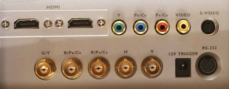

BenQ provides a pair of HDMI inputs and dual component video connections, though the second is a BNC-style RGBHV input. Composite and S-video are included and should never be used with a projector at this price point. The RS-232 connection is a funky 8-pin din connector that requires a cable in order to connect to most serial control devices. Finally, a 12V trigger allows the projector to control a drop down projection screen or other device based on the status of the W5000.
Dual HDMI, Dual component video (including 1 via BNC), 12V trigger and RS-232C control.
