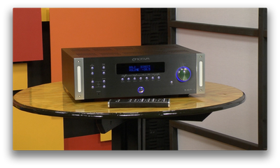

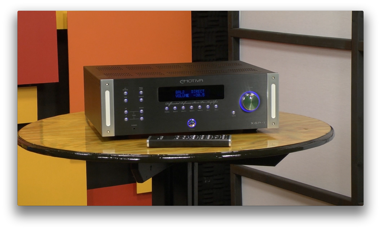

Emotiva brought something new to the world of stereo preamps this year. It's the XSP-1, a fully differential balanced stereo preamp. To our knowledge, this is the only product like it in the market at this price point. In fact, there are preamps in the $3-$5000 price range that aren't nearly this sophisticated. Fully differential means that the preamp literally has a separate analogue circuit for the positive and negative connections from the balanced XLR inputs to the XLR outputs. Differential circuits offer a big advantage in that they greatly reduce both noise and distortion.

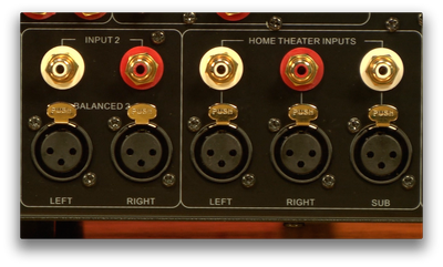

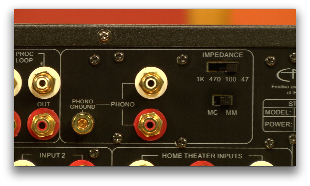

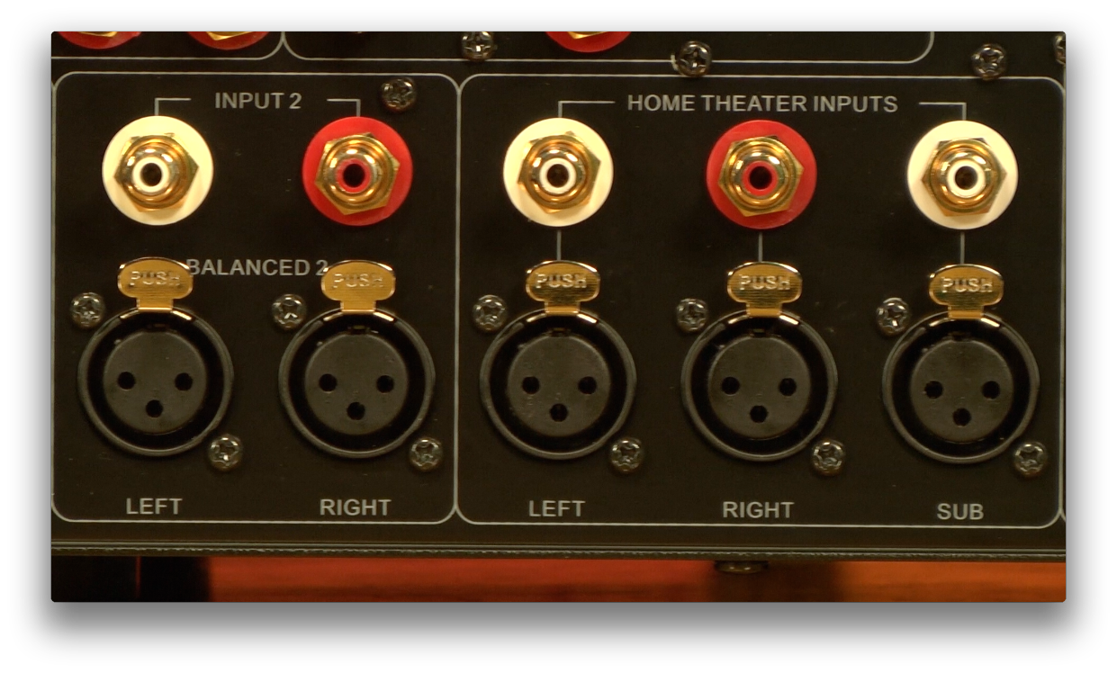

MM MC settingsAt less than $900 it's an amazing  product just based on the signal flow itself...but that's just the first feature. Let's look at the connections...The XSP-1 has two sets of balanced (XLR) line inputs and one set of balanced outputs. Those inputs will take up to 6V so there's tons of headroom. It also has four sets of unbalanced (RCA) inputs and a stereo RCA output. If you spin vinyl, you'll appreciate that Emotiva included a high-end phono preamp with both moving magnet and moving coil settings and even adjustable input impedance for the MC mode. And we won't rehash it here, but check out Emotiva's website and you'll find over 120 pages of Audio Precision tests and measurements—Emotiva is being extremely transparent about this preamp. For headphone lovers, there is a high current headphone amplifier on board with its own volume control. In fact, the digitally-controlled analogue volume remembers settings independently for both the headphone and main outputs.

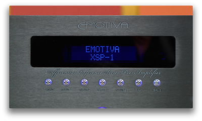

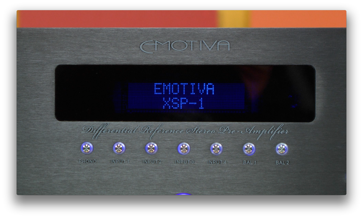

 LCD front display

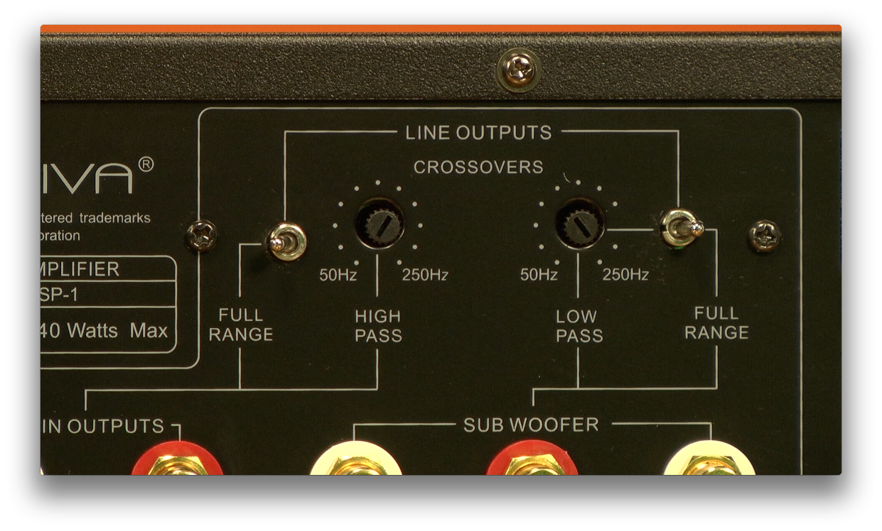

And the XSP-1 has something else that's very unique: dual stereo subwoofer outputs with full bass management. These can be routed stereo or summed. This is great for when you want to control bass management to a pair of stereo speakers in conjunction with a pair of stereo subs, or even if you have a full range system that you'd like more control over with respect to how the low frequencies are crossed over to the bass drivers.
sub crossover
Crossover duties are kept in the analogue domain with separate high pass controls for your mains and low pass for your sub(s). Bass management can also be completely bypassed.  This gives you very precise control over how your sub and mains interact so that you can take the most advantage of their individual strengths. Usually, you set the crossover at a point and high and low pass filters are set by the device. Emotiva has recognized that people looking for a fully balanced product probably have speakers that don't fall into easy presets.
The stereo sub outs are not so much for home theater because the XSP-1 only has a mono subwoofer input. But there is also a home theater bypass mode. Ok, basically, you can run the XSP-1 inline so that it receives the outputs from an AV receiver and allows you to bypass all processing and volume controls to allow complete pass-through when you decide to listen to surround. In this way you can do what a lot of people are doing these days, which is to multipurpose a high end two channel room that also lets you do surround sound for home theater.
 differential XLR inputs
There are trigger and IR inputs and outputs for easy integration into a universal remote system. An external processor loop is included as well.

As you'd expect from Emotiva, they've put together a very solid offering in the XSP-1 Differential Reference Preamp. What you won't expect is the $900 price tag for a fully balanced stereo preamp with top of the line construction and parts. With every single aspect of the XSP-1 well planned and thought out, we can think of nothing they forgot.
 beauty shot
From its fully differential construction, .25dB resolution on the volume control, home theater bypass mode, stereo subwoofer support with defeatable analogue bass management, user configurable high pass and low pass filters to the full featured phono input and true external processor loop, everything is here.  At this price, we can't think of any serious audiophile that wouldn't be interested in the XSP-1.  It's a unique product in this market and a gem for any audiophile that wants great performance and versatility often lacking in most alternatives.
