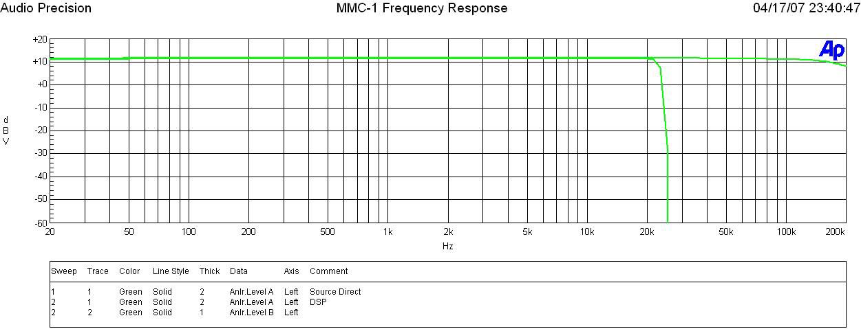

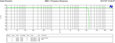

Frequency Response
MMC-1 Frequency Response
In “source direct” mode, the Emotiva preamp is rule flat beyond 100kHz with a 3dB point in excess of my test gear which is limited to 200kHz. In normal stereo mode, the frequency response is limited to the ½ the sampling rate of the ADC as expected which in this case was 22kHz.

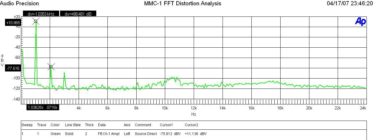

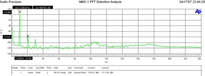

FFT Distortion Analysis
FFT Distortion Analysis at Full Power
At 3.5Vrms into a 600ohm load, the MMC-1 exhibited excellent distortion characteristics (10.865+77.616)dBv = 88.5dBV or 100*alog^-1(-88.5/20) = .0038% The slight rise in noise above 10kHz was perplexing, especially since the unit was engaged in “source direct”, but so low in the mud (-100dBV), that it really wasn’t worth further investigation.
