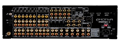

  • Product Name: Reference Series MMC-1
  • Manufacturer: Emotiva
  • Review Date: May 14, 2007 20:28
  • MSRP: $ 1199
Specifications
  • Precision Motorola Symphony™ based 7.1 Channel Dolby Digital, Dolby Digital EX, Dolby Pro-Logic II/IIx, DTS, DTS-ES, and DTS Neo:6 decoding
  • OSD (On Screen Display) for easy set up and calibration.
  • All inputs can be renamed and are completely configurable for triggers, zone assignment, gain trim, max level, etc.
  • Second zone audio capability; can play sources independent of the main zone
  • Full-time digital down-mix for two-channel tape recording, digital outputs, and second audio zone output from multi-channel digital sources
  • Direct two-channel analog bypass mode
  • Custom machined aluminum remote control
  • High performance FM/AM tuner with 40 presets
  • HDMI 2x1 internal switcher: Maintains 480i, 480p, 720p, 720i, and 1080i, 1080p resolutions
  • Three sets of 100 Mhz+ HDTV compatible wide-bandwidth component video inputs with two buffered outputs
  • Broadcast quality video up-conversion circuitry for all composite and S-video inputs.
  • Six audio/video inputs, each with audio, S-video and composite video
  • Three audio inputs
  • Moving magnet phono input
  • Eight channel analog audio input using RCA connectors for DVD-A, SACD, or other external multi-channel source. Ultra pure, all analog signal path.
  • Digital audio (S/PDIF) inputs for six sources: four coax or optical and two coax only
  • Coaxial and optical digital (S/PDIF) outputs provide two-channel digital down-mix from 5.1 sources for recording, etc
  • Balanced output for .1 channel with 3 additional single ended subwoofer outputs
  • All-digital bass manager with crossover frequencies of 40 to 160Hz
  • DSP based tone controls
  • Professional grade 24-bit A-to-D converter and 24-bit/192kHz Multi bit D-to-A converters
  • Separate trigger outputs and infrared inputs for both zones
  • High-current (500mA total) trigger outputs
  • Flash upgradeable memory & RS-232 control port
  • Modular internal construction
  • 3RU chassis with milled aluminum faceplate and silver colored accent panels. Indirect cobalt blue illumination.
  • Optional rack mounting hardware provided
  • IEC power inlet, 120/230 VAC configurable.
  • 5 year warranty
  • Weight - 25 lbs.
  • Dims: (HxWxD) 6” x 17.00 ” x 16 7/16"
  • Sounds as good as it looks
  • Super easy operation and setup
  • High Value
  • Lacks some of the most modern processor features as noted in our DMC-1 review
  • Average noise performance on some tests (see notes)
