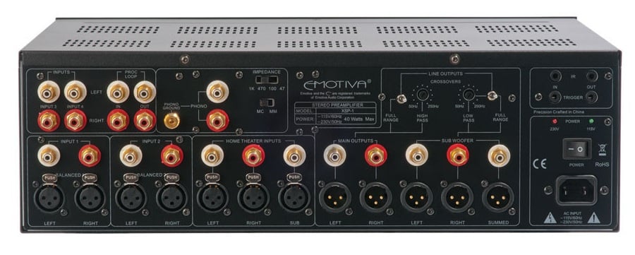

The XSP-1 has two sets of the balanced (XLR) line inputs and one set of balanced outputs. It also has four sets of unbalanced (RCA) inputs and a single output. There is the required phono input for vinyl lovers with MM/MC capability and adjustable input impedance for MC. Most interestingly is that the XSP-1 features dual subwoofer outputs which can be routed stereo or summed. Crossover duties are kept in the analogue domain with separate high pass controls for your mains and low pass for your sub(s). Bass management can also be completely bypassed.  This gives you very precise control over how your sub and mains interact so that you can take the most advantage of their individual strengths. Usually, you set the crossover at a point and high and low pass filters are set by the device. Emotiva has recognized that people looking for a fully balanced product probably have speakers that don't fall into easy presets.

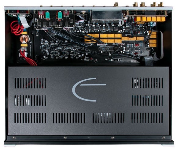

xsp1_top
The Emotiva XSP-1 has a few other niceties. most notably, you can integrate the XPS-1 into a home theater system allowing you to use it as a high end two-channel preamp or bypassing it being "ht bypass" mode so it runs transparently between your A/V processor and power amplifier.

I just received this product and the bass management does not work. Once the bass management switches on the rear are set, the measured response is identical regardless of the crossover frequency selected. That applies to both the mains and the subs. I have sent an inquiry to them (with plots to prove my point) to see what gives. Hopefully my unit is just malfunctioning.

The XSP-1 has provision for 2 subwoofers with bass management for normal listening but it only has one subwoofer input for home theater bypass operation. So it seems to me they forgot to have 2 subwoofer inputs. This makes the home theater bypass function unusable if you wish to have both of your subwoofers connected to the XSP-1. Your only choice is to send the subwoofer output output from the XSP-1 and your home theater receiver to your subwoofers separately, if your subwoofer has 2 inputs. If it doesn't, a 2 into 1 switch would be required. If you have both of your subwoofers connected to the XSP-1(L and R outputs), you still cannot use the home theater bypass feature for one of them by connecting to the one subwoofer input from your home theater receiver, as the left and right outputs on the XSP-1 are attenuated by 3 db each.That's a deal breaker for me, as the whole reason I'm looking for an analog preamp is for home theater bypass operation. 2 subwoofer outputs with only one subwoofer input makes no sense
interesting. I missed that but will inquiry. thanks.
christopherb210 posts on November 03, 2012 10:13
