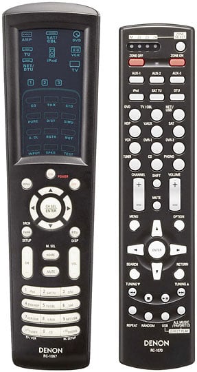

AVP-remotes.jpgThe AVP-A1HDCI comes with two remote controls – the RC-1067 which serves as the main zone remote control and the RC-1070 which functions as a simplified remote for the main zone as well as multi zone control. The RC-1067 is an updated version of their learning/multibrand touchscreen electro-luminescent remote originally offered with the AVR-5805. Gone however are some of the Colecovision style membrane push buttons and instead this remote consists of real push buttons for main function control such as selecting inputs, adjusting volume, changing channels, and using a push button fly wheel to navigate the OSD menus. The touchscreen is only used to select the device you want the remote control to operate or the surround/soundfield mode you desire. The tactile feel of this remote has been greatly improved and you can pretty much operate it with one hand without any issues. I was also pleased to see the RC-1067 requires only 2AA batteries unlike its predecessor that required 4AAA’s to operate. I have a few major gripes with this remote starting with the fact that you can no longer select what PLIIx mode you want to be in via a remote hot key. Another annoyance is the very inconspicuously “M.SEL/Home” button that when pressed will select which HDMI output you desire to send video signal to. The first time I accidentally hit this button in my dark theater room I lost my picture and had to trouble shoot for nearly half an hour until I realized the culprit. This is a dangerous button to be offered with such easy access.
I was quite puzzled by how difficult I found it to use the radio on this product. For one they didn’t integrate the HD radio feature into the standard AM/FM tuner input. Instead there were two discrete inputs and antenna hook ups for both. Since you can’t control any tuner functions via the front panel of the processor, you have to rely solely on the remote control. To make matters worse, once you select the tuner input, you have to navigate the touchscreen. To operate AM/FM, you have to select “TU” then “Dev1”. For HD radio, the input is labeled “DTU” which makes little sense. In order to operate it, you must select “Net/DTU” and “Dev2” via the touchscreen of the remote. In either case you won’t be allowed to use the center circle hard buttons or CH up/down functions to make your selections for tuner mode or changing stations. A tuner shouldn’t be this difficult to operate in this day and age and I suspect it will really discourage its use among casual users. Finally the location of the on/off buttons seem a little out of place as I found myself accidentally hitting the “off” button on many occasions since that is exactly where I position my thumb when holding the remote with my right hand.

The RC-1070 is a nice addition and perhaps the most comprehensive multi zone remote control I’ve seen. You can pretty much control the entire processor with this remote as it has virtually all of the functionality of the RC-1067 but in push button version. Despite my criticisms, I still feel this is the nicest remote solution I’ve seen Denon offer in their products and I was relieved at how intuitive they were to operate most of the time.
