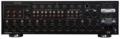

Now some of the stuff on the back of the PSPHD Procise processor are going to look a little unfamiliar to consumers. Specifically the little green inputs on the top right corner. Don't be afraid, those are for the installers and we're not going to worry about them. You also don't find a bunch of colors clearly delineating inputs and outputs and the whole thing looks a little industrial. That's also by design. Installers don't need guides. They don't need labels for inputs like DVD or CD. They'll assign them all by number. Frankly, we like that as well.
There are six HDMI 1.3a inputs and a single output on the back of the Crestron PSPHD Procise processor. You've got digital inputs for audio including six coaxial and four optical. There are eight pairs of RCA stereo analogue audio inputs, a single pair of balanced stereo inputs, an AES/EBU input, and a set of RCA 7.1 analogue inputs. For outputs you have both balanced and RCA for each channel including three independent subwoofer channels. Lastly there is an RCA/balance stereo downmix output plus a mono output. While most consumers wouldn't use something like this, it is absolutely necessary for making distributed audio a snap.
