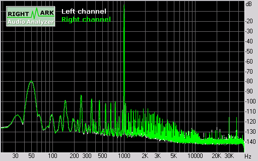

The noise floor was slightly higher than on the analog inputs, and primarily consists harmonics of the power supply residual at 50 Hz (150 Hz, 250 Hz, ...):

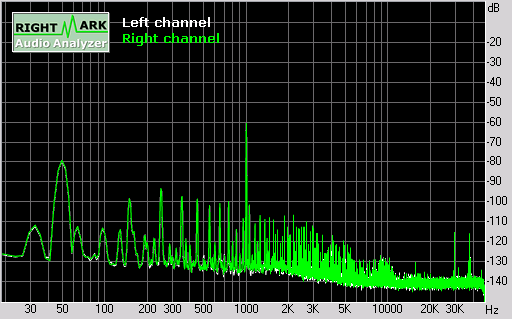

The unweighted dynamic range was around 82 dB and the A-weighted dynamic range was around 93 dB. This is about average for a pre/pro:

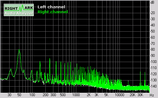

Unweighted THD+noise at -3dB FS was 0.018%, and the corresponding A-weighted figure was 0.005%, which is slightly worse than the 0.003% quoted in the manual:
Intermodulation distortion (based on 70Hz + 7kHz fundamentals) was also low: 0.017% unweighted and 0.006% A-weighted.

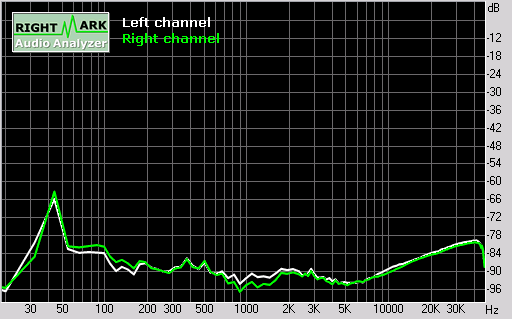

Finally, stereo crosstalk was fairly low and generally hovered around -90dB FS apart from around 50 Hz and above 10 kHz:
