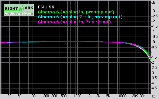

Frequency Response
The Cinema 6 was essentially flat all the way to at least 48 kHz (the dip in high frequencies is actually due to a high pass filter in the E-MU 1212M):

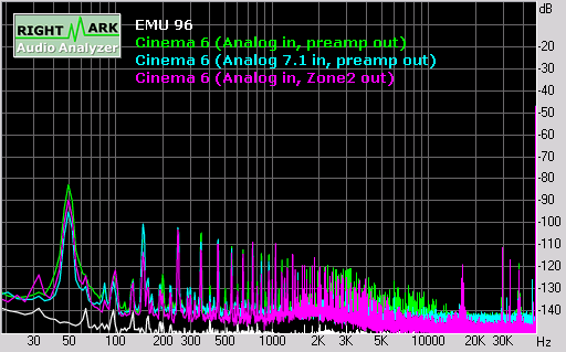

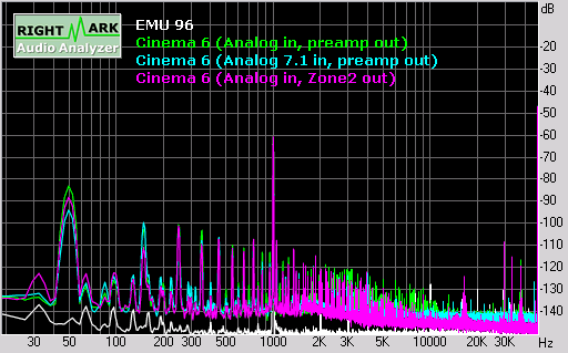

Signal to Noise Ratio
The noise floor was convincingly below -100dB, with the main contributor to noise being the residual 50Hz spike from the power supply and harmonics of 50 Hz (primarily 150 Hz, 250 Hz, ...) There seemed to be a few spikes around 17 kHz and above 30kHz:
The unweighted dynamic range was around 86 dB and the A-weighted dynamic range was around 101 dB. Not quite the 110dB claimed in the manual but not bad for a pre/pro.
