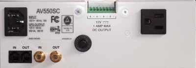

AV550SC topThe Tripp LIte AV550SC is a small metal box, approximately 8x7x3 and can sit on one of three sides. There are four power outlets available, marked as Router, Modem, Aux and Aux. The Power button exists on the large side of the UPS and two LEDs (green & red) indicate power and overload/check battery states. On the one side (where the router power outlet is) exists the 10A breaker reset button, cable protection (2.2GHz loop through), and an in/out port that will only support phone line protection (not Ethernet). There is also a 12VDC output (1A max) voltage bank for use with controlling other trigger-ready devices.

We installed the AV550SC in the equipment closet and plugged in a cable modem, 8-port gigaswitch, Universal Remote Control MSC-400 and a Denon iPod dock system. There are two screw holes on the rear of the unit that means it could theoretically interface with a wall-mount system, however no hardware is included and the user manual and website offer nothing in terms of helpful information. Additionally, if you open up the system to access the holes from within (to bolt or screw it to a wall) you void your warranty. Since we couldn't easily wall mount it, we set it on the shelf so that the power button was facing up and we had access on the other two sides to the power outlets. It fit snugly into the corner and gave us plenty of room for our plugs. We powered the entire unit by plugging it into a 20A wall outlet. Next we connected our cable modem line through the in and out ports, which gave us protection from the frequent electrical variations we encounter here in the lightning capital of the world. If you have all of your products power protected, but don't break the cable line, you're likely to suffer damage should a spike ever come through that "hole" in the system. Believe us, we've seen it happen and it's not pretty.
