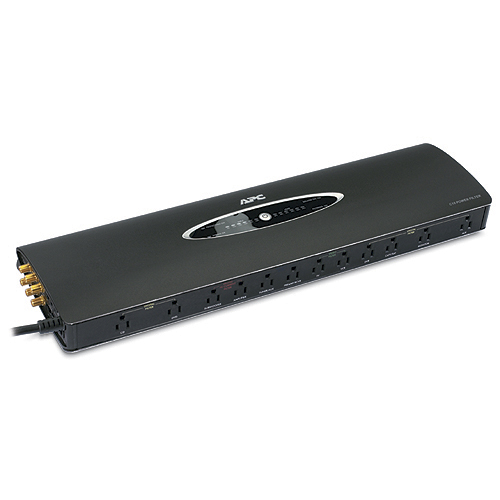

The APC C10 is about as easy to setup as any standard power strip. You simply connect your cable and Ethernet devices to the appropriate side mounted I/O’s and plug in your components to the appropriately labeled outlets. I recommend plugging your subwoofer, and receiver into the “delayed” high current outlets which is a good idea to reduce inrush currents when powering up the entire system. With 12 surge protected outlets (2 for video, 6 for digital sources, 2 delayed high current and 2 analog),3 RF I/O’s, 1 RJ11 phone/fax input / 2 outputs and 1 RJ45 ethernet I/O, there are plenty of connection options to ensure your entire system is protected.

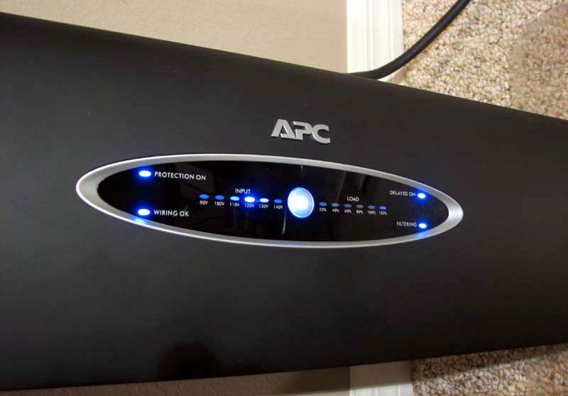

There are a number of lights on the front panel which indicate the state of the unit. You have some control over them with respect to turning all of them off but the main power and protection ones by pressing and holding the on/off button.
  • Protection On - on/off LED status illuminates blue when the unit is working properly
  • Wiring OK - LED status illuminates blue if your outlet wiring is correct
  • Filtering - LED status illuminates blue when the unit is working properly
  • Input - monitors line voltage via blue LED indication from 90V to 140V in 10V increments
  • Load – monitors the load condition on the line via LED indication from 20% to 120% in 20% increments
  • Delayed On – LED illuminates blue when the delayed outlets are active (6 sec delay during initial power up)

I brought this unit over to my brother’s house and wired it to his home theater system which consisted of an older Yamaha A/V receiver, Sharp Aquos LCD display, Toshiba DVD player, Sony CD changer, Brighthouse cable box, and a JVC VCR. I neatly horizontally placed the unit under his A/V rack on the ground which was out of sight but still accessible. The C10 has pads on the bottom which increases static friction so it can be placed horizontally on the ground without fears of it moving around either from cable tension or excessive bass output from a local subwoofer. The unit also comes with a metal bracket which is said to be used for wall mounting but comes with no hardware to attach and I didn’t quite understand how to secure it to the unit. Regardless I feel the C10 is much less obtrusive when placed on the floor under an entertainment center then being mounted on a wall.
