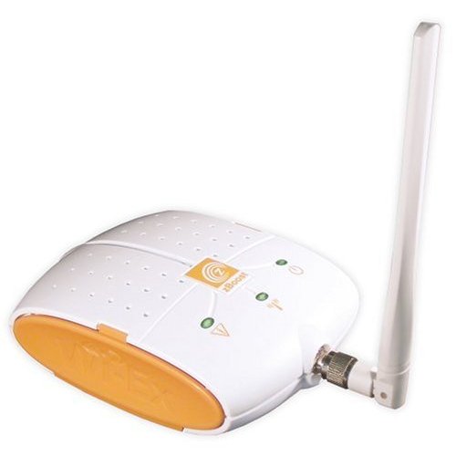

The device is very simple.  In the box you will find a 35 foot section of white RG-6 cable, a white antenna that looks like a piece of PVC pipe, and the base station, which looks like a wireless router or a cordless phone base station.  The base station has an included power adapter.
Not only is the device simple, but so is the concept.  Find a spot outside of your home such as your back porch, or an area near a window and mount the antenna.  Run the RG-6 into your home to the base station, and plug it all in.  Once you power up the base station, you should see an improvement in your signal.

I had mixed results with the zBoost.  I started with a friend's house who has very sketchy service when inside, and often has to walk outside to talk on his Treo.  Since we were not ready to start drilling holes and running cable, we tried the antenna both on the back porch, and then upstairs on a front porch.  We just ran the cable across the floor down to the den where we plugged in the base station.
zboost houseAlthough we noticed a little fluctuation in the signals on our phone, overall we could not detect a huge difference.  We tried both locations, but could not determine a clear improvement.  I left the setup at his house for a week, so he and his wife could try to determine whether or not they noticed a difference.  At the end of the week, Dan brought the unit back to me and said they had decided that there was not enough difference to justify a permanent installation.
In fairness, we probably did not take the time necessary to find the ideal spot around the perimeter of the home that would have produced the best possible reception.  Even when outside of his home, the reception is still a bit spotty, and this product cannot make a good signal out of no signal.  Placement of the antenna is critical, and if is not mounted in an area with a strong cell signal, you will likely not see any improvement indoors where you have the base station.
For my second test, I took the unit to a friend's store.  Connecting Point is an Apple authorized reseller, and I know that inside of the store (located in a small strip mall) there is ZERO service for those of us with AT&T (read:  iPhone) phones.  Since the owner has an iPhone, this kinda stinks, and I figured this product would be the answer to his problem.
I clipped the antenna under the windshield of my truck, parked just in front of the store and ran the cable straight into the front door to the base station, which I had installed towards the back of the store.  Once I turned it on, the magic happened.
My iPhone went from ZERO bars of service to THREE-FIVE bars of service.  Although the signal fluctuated, it never dropped below 3 bars.  This was a huge improvement.  I usually have at best a 50% chance of receiving or making a call in the store.  The entire hour or so that I was there, I had no problems with signal.  Incoming and outgoing calls were no problem.
