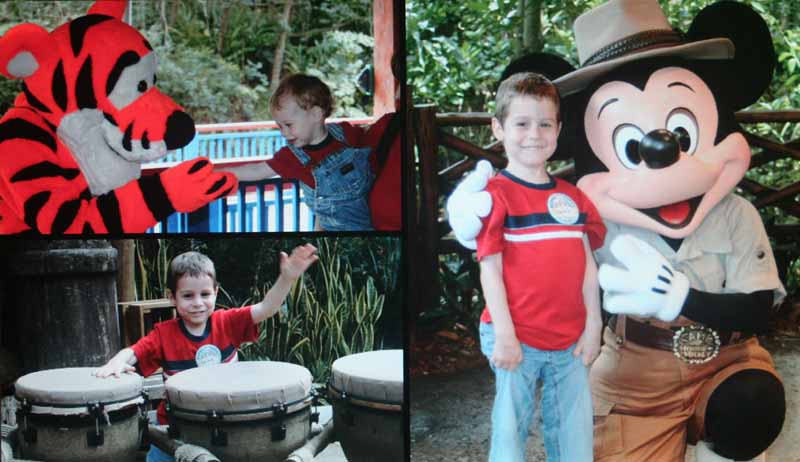

Photos looked great on the DPF-1021 and for that the little photo frame seems to do a fine job. Images were bright (blacks were mostly a medium to dark gray) and only lost a little contrast once you got off axis to the frame. Overall it was a nice image that really appealed to guests coming to our home and seeing the numerous photos that traveled through the MosaicView interface. Our youngest son also delighted in seeing himself come up over and over again on the screen - reminding us of who we were watching as if we'd forgotten seeing it 90 seconds previous.
Colors are vibrant and images are crisp

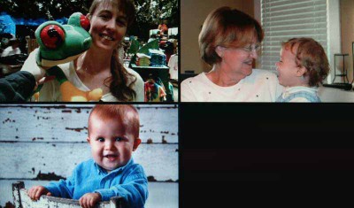

When using MosaicView for the first time, be aware that the system must first "load" the pictures into place. This means there will be some black on the screen until the first 2, 3, or even 4 pictures are pulled into the display for viewing. Once this is complete the images cycle continuously without any blanks.
MosaicView loading up one pic at a time
