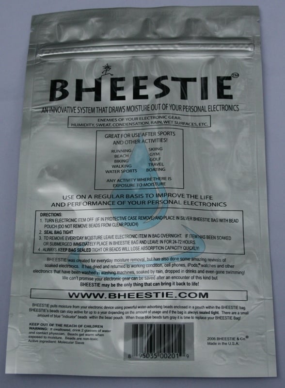

Bheestie_backBheestie_backWhat is in a bag? Well, traditionally air but in the case of the Bheestie Bag, it is air and a smaller bag of pellets. There are clear instructions NOT to open this second bag of pellets. This makes sense as free pellets could work themselves into the nooks and crannies of your device, creating a different, though probably just as deadly, problem. The bag itself looks like something people on the space station would open to get a napkin or drink out of. The silver material is very space age in appearance with the blue and black highlights only adding to the effect.
The bag arrived sealed in another bag (that makes three so far) which was then sealed in a shipping bag (up to four). I couldn't see if the mailman carried the package in a bag (five) though that seems likely. Each of the top two bag layers need to have the tops ripped off before use: The top bag to get the Bheestie Bag out, the Bheestie Bag top to get the device in. There is a zip top closure on the Bheestie Bag to keep the device in and moisture out.
This is apparently a very key feature of the Bheestie Bag - the pellets on the inside are highly absorbent and will lose that absorbency quickly if exposed to the air for prolonged periods of time. Here in Florida, this is especially true as even in the winter the humidity can be quite high. This is why I conducted the tests first before I removed the interior bag of pellets for my picture. Each bag of pellets has a number of "indicator" pellets. These let you know when your Bheestie Bag needs to be replaced. While the pellets are still good and able to absorb moisture, they are blue. Once they turn gray, it is time to get a new Bheestie Bag. This is actually a feature I was hoping to see with the Bheestie Bag as it takes the guesswork out of replacement times.

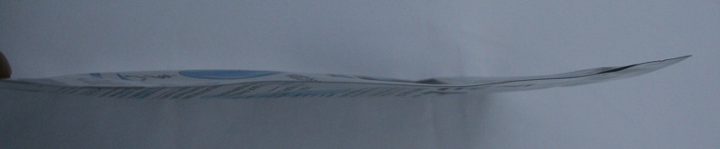

Bheestie_side
It's small. Well, the bag isn't small but the contents are tiny. The little bag of pellets inside or so small that you'd think they couldn't possibly absorb that much water. That remains to be seen at this point in the review but from a transportability standpoint, the small amount of contents of the bag means it can be easily placed in a laptop case, a gym bag, or just about anywhere else. Try lugging around a bag of rice "just in case." The compact size of the Bheestie Bag must be considered a huge plus.
