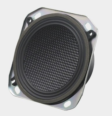

 Sony Woofer BDV-N8100W
An 80mm woofer from Sony's BDV-N8100W
Suffice it to say, judging by the size of the drive units alone, the audio performance of this system isn't going to be much to write home about. 180mm does not a subwoofer make, though for the price we can understand Sony can’t squeeze in a pair of SVS PB13-Ultras. What’s a little more problematic in our view is the use of a pair of 60mm “woofers” on the center speaker. At slightly under 2.4”, we’re talking about a drive unit slightly smaller than what is utilized by a Bose cube. Consequently, we expect Sony’s center speaker to suffer one big flaw, namely being unable to effectively dig deep enough to successfully blend with a subwoofer. At best, the included subwoofer is going to have to shoot for an abnormally high crossover frequency, which can lead to issues of localization. At worst, there could be a hole in the system response stemming from the speaker which handles the bulk of the content in a home theater.
