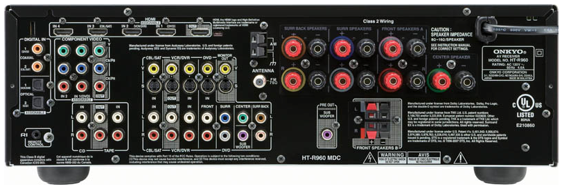

The Onkyo HT-R960 has the ins and outs you'd expect on a mid-fi A/V receiver. As we indicated above, the four HDMI inputs will handle HD sources effortlessly and pas them to the single output, with both audio and video being read from the sources - a big improvement over some of Onkyo's lower HT-R receivers. Dual component video inputs means that legacy products will also be able to get tied into this receiver - and there's no need to connect both component and HDMI to your display since the receiver offers video upconversion to HDMI thanks to the Faroudja DCDi/Edge processor. There are also three other composite video inputs and S-video connections. In addition to these video inputs there are dual stereo inputs for CD and Tape (hey, what's that?) and two each of optical and coax S/PDIF connections.
HT-R960 back panel
Note the 7.1 analogue inputs but no preamp outputs or iPod docking connector
In terms of speaker connections, this model provides 5-way plastic binding posts for all primary (left/right/center/surround/surround back) speakers, but the Front B speakers get spring clips. This is not uncommon at this price point, but realize that spring clips of this type do best with 18 gauge or higher (smaller) cable. What we were surprised about was the lack of ability to reroute the amplifiers for a second Zone or bi-amping. The HT-R960 receiver instead uses Speaker B for a second "Zone" but if used, disables the Surround Back speakers. You can also not independently select a source for the Speaker B output. It was interesting to note that the less expensive HT-R570 included support for Sirius satellite radio, while the supposedly stepped up HT-R960 does not.

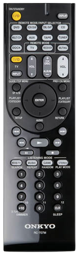

HT-S9100THX remoteThe remote that comes with this unit is sufficient enough to handle most basic systems (TV, DVD player and the AV receiver) but don't expect to have it operate your DVR or more sophisticated cableTV functions. It works via preprogrammed codes and cannot learn commands from other remote controls. The layout is intelligent, with direct access over inputs and the four listening modes (which can be further toggled by repeatedly pressing each button.) There is no backlight on this remote, so plan on using it during the day or learning where everything is for nighttime use. There is also a button to control a second audio Zone. A good universal remote should land this thing in storage pretty quickly - and that's our recommendation for most entry level remotes.
