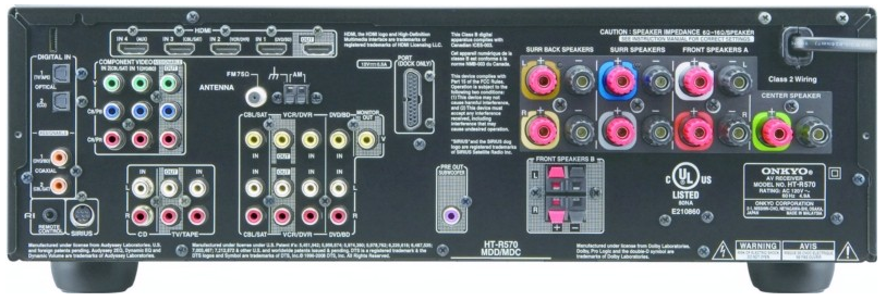

The Onkyo HT-R670 (which is very similar to their TX-SR607) has the ins and outs you'd expect on a basic A/V receiver. As we indicated above, the four HDMI inputs will handle four HD sources effortlessly to the single output, with both audio and video being read from the sources - a big improvement over some of Onkyo's lower HT-R receivers. Dual component video inputs means that legacy products will also be able to get tied into this receiver. In order to use both, you'll need to connect both component and HDMI to your display since the receiver does not offer any video upconversion. There are also three other composite video inputs, but no S-video connections (which is just fine with us). In addition to these video inputs there are dual stereo inputs for CD and Tape (hey, what's that?) and two each of optical and coax S/PDIF connections.
HT-R670 back panel
Note the lack of 5.1 analogue inputs
In terms of speaker connections, this model provides 5-way plastic binding posts for all primary (left/right/center/surround/surround back) speakers, but the Zone 2/Height Channel speakers (for Dolby Pro Logic IIz) get spring clips. This is not uncommon at this price point, but realize that spring clips of this type do best with 18 gauge or higher (smaller) cable. This is also the first HT-R receiver that allows bi-amping of the main speakers through re-routing amps from the Surround Back speakers. In addition, the TX-SR607 adds preamp outputs for a second parallel subwoofer and another set of A/V inputs for a gaming system (complete with an addiitonal, fifth, HDMI input). It was interesting to note that the HT-R570 included support for Sirius satellite radio, while the higher priced HT-R670 does not (the TX-SR607 includes it as well).

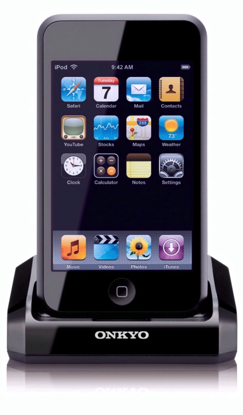

UP-A1That weird-looking D-connector on the back is a proprietary iPod dock port that Onkyo uses to connect to the included UP-A1 iPod dock. This dock lets you incorporate the iPhone right into your home entertainment system. The UP-A1 supports your iPhone or iPod's ability to send music, movies, TV shows, music videos, and video podcasts to the HT-R670. It draws a steady power supply from the AV receiver via the same convenient cable that delivers the video and audio signals. The UP-A1 also offers handy features found on previous Onkyo docks: the ability to recharge your iPod or iPhone. On compatible receivers (of which the HT-R670 is not), the dock also gives you onscreen display for content navigation and selection.

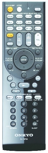

HT-R670 remoteThe remote that comes with this unit is sufficient enough to handle most basic systems (TV, DVD player and the AV receiver) but don't expect to have it operate your DVR or more sophisticated cableTV functions. It works via preprogrammed codes and cannot learn commands from other remote controls. The layout is intelligent, with direct access over inputs and the four listening modes (which can be further toggled by repeatedly pressing each button.) There is no backlight on this remote, so plan on using it during the day or learning where everything is for nighttime use. There is also a button to control a second audio Zone. A good universal remote should land this thing in storage pretty quickly - and that's our recommendation for most entry level remotes.

I have what is probably a ridiculously basic question about the HT-S6200. The 'First Look' article mentions a lack of 5.1 analogue inputs. What are the implications/limitations of this? In what cases might this be a disadvantage?
5.1 (or 7.1) analog inputs are necessary if you have a universal player that does not have any digital outputs and if the player was purchased recently that would be very rare.
1. If the player has optical or coax digital outputs, you can get 5.1 Dolby Digital or DTS without requiring analog inputs on the receiver.
2. If the player supports the newer lossless formats, like Dolby TrueHD, but does not have HDMI outputs, then you'd need to have the player do the decoding and send the audio out its analog audio outs and into the receiver's analog audio inputs.
3. If your player supports DVD-A or SACD but does not have HDMI outputs, then you'd also need analog audio outs on the player and analog audio inputs on the receiver.
In short, if you don't play DVD-A or SACD, you don't need analog inputs on the receiver. If the player and receiver have HDMI outputs/inputs then you can play any format whatsoever and definitely don't need analog inputs on the receiver. 5.1 analog inputs are a legacy connection and will soon be gone forever just like s-video has been disappearing from receivers.
