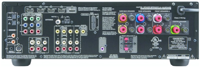

The Onkyo HT-R570 has the ins and outs you'd expect on a basic A/V receiver. First off, the four HDMI pass-through inputs will switch four HD sources effortlessly to the single output. Dual component video inputs means that legacy products will also be able to get tied into this receiver. In order to use both, you'll need to connect both component and HDMI to your display since the receiver does not offer any video upconversion. There are also three other composite video inputs, but no S-video connections (which is just fine with us). In addition to these video inputs there are dual stereo inputs for CD and Tape (hey, what's that?) and two each of optical and coax S/PDIF connections.
HT-R570 back panel
Note the lack of 5.1 analogue inputs
In terms of speaker connections, this model is the first where all primary (left/right/center/surround/surround back) speakers get 5-way plastic binding posts, but the Front B speakers get spring clips. This is not uncommon at this price point, but it does indicate the lack of a dedicated Zone 2 for this system, opting instead for a second parallel amplified set of B speakers. Spring clips of this type do best with 18 gauge or higher (smaller) cable. While the similar TX-SR507 has a dedicated Zone 2 output, the HT-R370 utilizes those amps for the Surround Back channel. In addition, the TX-SR507 adds preamp outputs for Zone 2 and Surround Back channels (great for adding a wireless solution for your rear speakers). It was interesting to note that the HT-R570 included support for Sirius satellite radio, while the TX-SR507 did not.

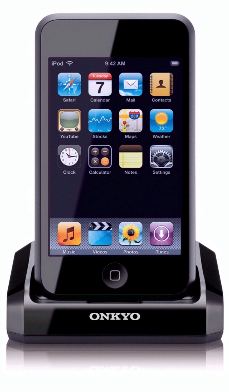

UP-A1That weird-looking D-connector on the back is a proprietary iPod dock port that Onkyo uses to connect to the included UP-A1 iPod dock. This dock lets you incorporate the iPhone right into your home entertainment system. The UP-A1 supports your iPhone or iPod's ability to send music, movies, TV shows, music videos, and video podcasts to the HT-R570. It draws a steady power supply from the AV receiver via the same convenient cable that delivers the video and audio signals. The UP-A1 also offers handy features found on previous Onkyo docks: the ability to recharge your iPod or iPhone. On compatible receivers (of which the HT-R570 is not), the dock also gives you onscreen display for content navigation and selection.

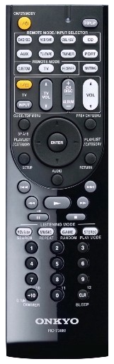

HT-R570 remoteThe remote that comes with this unit is sufficient enough to handle most basic systems (TV, DVD player and the AV receiver) but don't expect to have it operate your DVR or more sophisticated cableTV functions. It works via preprogrammed codes and cannot learn commands from other remote controls. The layout is intelligent, with direct access over inputs and the four listening modes (which can be further toggled by repeatedly pressing each button.) There is no backlight on this remote, so plan on using it during the day or learning where everything is for nighttime use. A good universal remote should land this thing in storage pretty quickly - and that's our recommendation for most entry level remotes.
