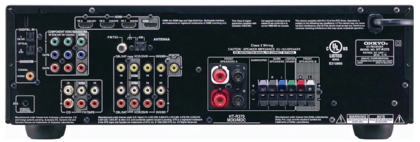

The Onkyo HT-R370 (which is almost identical to their TX-SR307) has the ins and outs you'd expect on a basic A/V receiver. First off, the three HDMI pass-through inputs will switch three HD sources effortlessly to the single output. Dual component video inputs means that legacy products will also be able to get tied into this receiver. In order to use both, you'll need to connect both component and HDMI to your display since the receiver does not offer any video upconversion. There are also three other composite video inputs, but no S-video connections (which is just fine with us). In addition to these video inputs there are dual stereo inputs for CD and Tape (hey, what's that?) and two optical and one coax S/PDIF connections.
back panel
Note the lack of dedicated LFE/sub line level output
In terms of speaker connections, the main left/right speakers get 5-way plastic binding posts, but center, surrounds, the passive subwoofer and B speakers get spring clips. This is not uncommon at this price point, but it does limit the type of speaker cable you'll want to use. Spring clips of this type do best with 18 gauge or higher (smaller) cable. Of primary significance here is the lack of a dedicated subwoofer/LFE line level (RCA) output. While the similar TX-SR307 has a dedicated subwoofer/LFE output, the HT-R370 removes this in favor of powered outputs. That means that any aftermarket subwoofer you buy as a future upgrade will need to have the ability to accept speaker level inputs. Examples of subs with this feature include the Axiom Audio EP125 ($375), Aperion Audio Bravus 8A ($319), and the Yamaha YST-SW216 ($139.95).

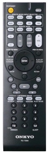

remote controlThe remote that comes with this unit is sufficient enough to handle most basic systems (TV, DVD player and the AV receiver) but don't expect to have it operate your DVR or more sophisticated cableTV functions. It works via preprogrammed codes and cannot learn commands from other remote controls. The layout is intelligent, with direct access over inputs and the four listening modes (which can be further toggled by repeatedly pressing each button.) There is no backlight on this remote, so plan on using it during the day or learning where everything is for nighttime use. A good universal remote should land this thing in storage pretty quickly - and that's our recommendation for most entry level remotes.
