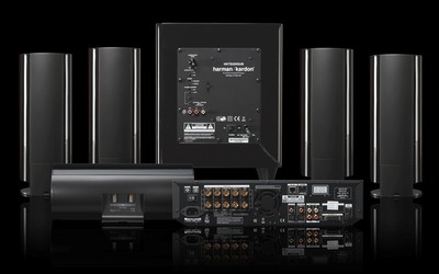

The Harman Kardon BDS 800 comes with four identical satellite speakers, a matched center, a sub, and a combo blu-ray player and receiver. Harman's material says that the speakers are a "two-way, dual driver" but we can clearly see three drivers on the front. That probably means that there is a tweeter and a woofer that are powered with the other woofer operating as a passive radiator. This is a nice design for a speaker that is meant to be placed near a wall (as these wall-mountable satellites often are) as it extends the bass without the addition of a port. The center shares the same design but is meant to be lying on its side. The speaker terminals on the satellites are the gold-plated, push type which you push down to reveal a hole for your wire. This limits you to really only bare wire connections and usually to no larger than 12 gauge wire. There is a panel which you can remove to hide the connections on the satellites - a nice WAF feature. The drivers consist of two 3" flat panel drivers and a single 1-inch "Lite dome" tweeter. All the drivers are magnetically shielded.
We had to go to the user manual to get information about the sub. It is downfiring and small sporting an 8" driver. It is, surprisingly, not ported having a sealed design. It has phase and volume controls plus auto on/off and bass boost. The bass boost is probably included for larger rooms and to offset the lack of port. There seems to be no crossover control indicating that it will be handled by the receiver/Blu-ray unit. The sub weight just under 20 pounds and has a 10.5" square footprint and is just under 14" tall.
harman_back
The receiver, for lack of a better word, assumes that the only HDMI device you'll have is a Blu-ray player as there are no other HDMI inputs. The integrated Blu-ray will decode all the latest HD audio formats and will output 1080p. There are no video inputs at all on the back but Harman has included a pair of optical and a single coaxial digital audio inputs plus a pair of RCA analogue audio inputs. The speaker terminals are 5-way binding posts which is a nice feature. There is a FM antenna input as well as a Ethernet port for BD-Live features. The front panel has a USB port that can access music and pictures. The BDS 5 receiver can put out 65 watts per channel, 20Hz – 20kHz, @ <0.1% THD, both channels driven into 6 ohms which should be more than enough power for the speakers. The HDMI version is 1.3a which means no 3D support or any of the latest features.
