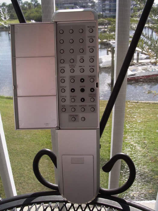

RC-1007 Remote Control
The supplied remote (RC-1007) is a relatively slim, easy to handle remote control. The lack of back lighting and poor tactile feel of the back panel functions make it a useful primarily in reasonably well-lit rooms lest you risk hitting the wrong function key and interrupting your movie watching experience (as I did on more than one occasion.) The front face of the remote controls system volume and power up, DVD navigation, input selection, and sports a Help function key to rescue neophytes from themselves in the event they misconfigure the system and/or can't get it to operate properly. While the back panel keypad contains numeric keys and more geek tweakability of surround parameters, tone controls, DVD angle, etc. Oddly I found one of the most useful features on the back panel. I personally felt the Zoom Mode should have been on the front of the remote control since it's a feature that will likely be used by many connecting this system to a standard 4:3 display and wanting to minimize black bars while watching widescreen movies.
With the stored remote codes, I was able to power up and change inputs on my el cheapo Sansui 27" CRT TV, though control functions were very limited. Since this remote isn't programmable there was little I could do other than use a dedicated universal remote control. It got the job done, was fairly intuitive, and, provided you had adequate room lighting, served its purpose as expected.
