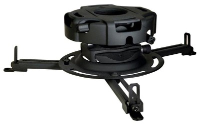

  • Product Name: PRG-UNV Precision Gear Projector Mount
  • Manufacturer: Peerless Industries, Inc
  • Performance Rating: StarStarStarStarStar
  • Value Rating: StarStarStarhalf-star
  • Review Date: July 17, 2008 09:07
  • MSRP: $ 258
Specifications
  • 50 lb Weight load capacity

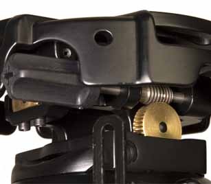

  • Patent pending precision gear provides accurate projector image alignment
  • Two adjustment knobs control projector image alignment
  • Horizontal wrench access slots make flush mounting installations fast & easy
  • Pre-assembled design reduces installation time
  • Quick release mechanism to easily service projector
  • Cable management allows cables to be routed through projector mount out of sight.
  • Security hardware included for theft prevention
  • Tilt: +/- 20 degrees, Roll +/- 10 degrees, Swivel 360 degrees
  • Available with SpiderĀ® Universal adapter plate, model specific adapter plate, or universal clamp style adapter plates
  • Incredibly convenient
  • Full controls for roll, tilt, and swivel
  • Supports up to 50 lbs
  • Very expensive
