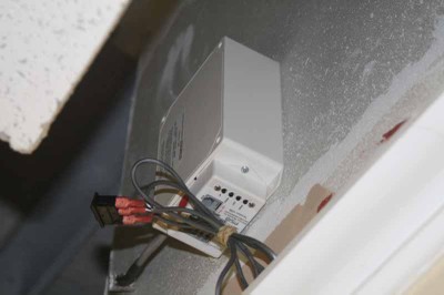

adjustmentsNow that the lift was securely anchored in and all the plugs were safely connected, it was time to play "Let's see what this button does".  One push of the "Down" button revealed the lift magically dropping from the ceiling.  Looking at the mechanisms driving the cage (very industrial, as earlier mentioned), I expected a not-so-pleasant sound when in use.  I was surprised to hear a very slight hum when in motion.  The cage dropped to its full "down" position and stopped.  Pressing the Up button had the same positive results. Now we moved on to the fine adjustments.
There are manual and electrical adjustments for the drop of the cage.  We did not need to use the manual adjustments, which only require loosening a 7/16" bolt on each leg of the cage.  The included hex-wrench was used to make the adjustments on the electric motor.  With a few twists of the wrench, the travel of the lift was dialed in perfectly.  It really didn't take too much back and forth and we were able to get exactly thr height we needed. With the ceiling tile attached to the lift, when the cage reaches the top, you could never tell that there was 100 lbs. sitting over your head.

mounted controller
