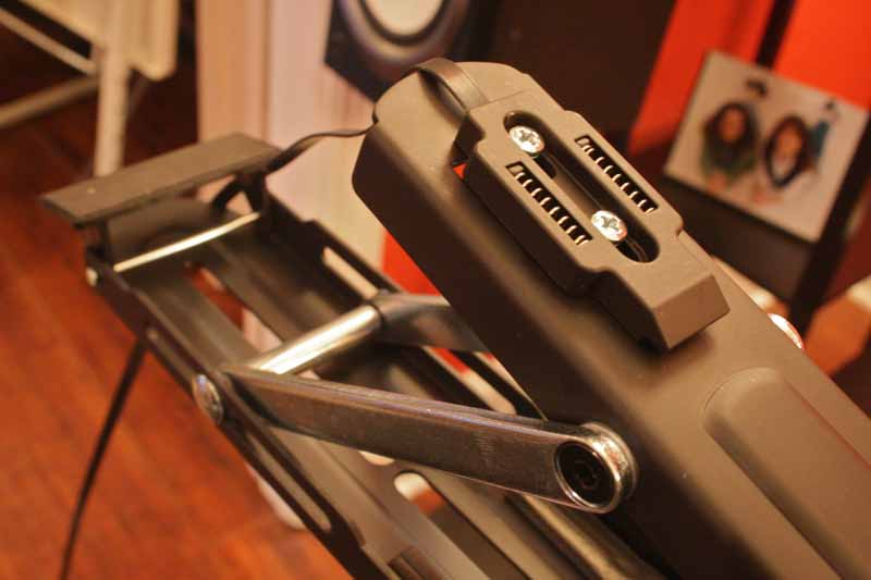

Opening up the TH-3060-LPT we were greeted with the expected back plate, mounting hardware and tilt arms. In any basic flat panel tilt mount, you mount the base plate to the wall (either studs or masonry) and affix the tilt arms to the back of the TV using the supplied hardware. This is fairly standard fare, but what we found interesting was how thin the tilting mechanism was and, more importantly, how well it seemed like it would work on an oversized screen. Unlike many tilt mounts, which are merely friction-based hinges, the TH-3060-LPT uses a spring-assisted twin arm mechanism that lets you adjust tension until you can literally control the tilt of even a heavy display with a single finger.

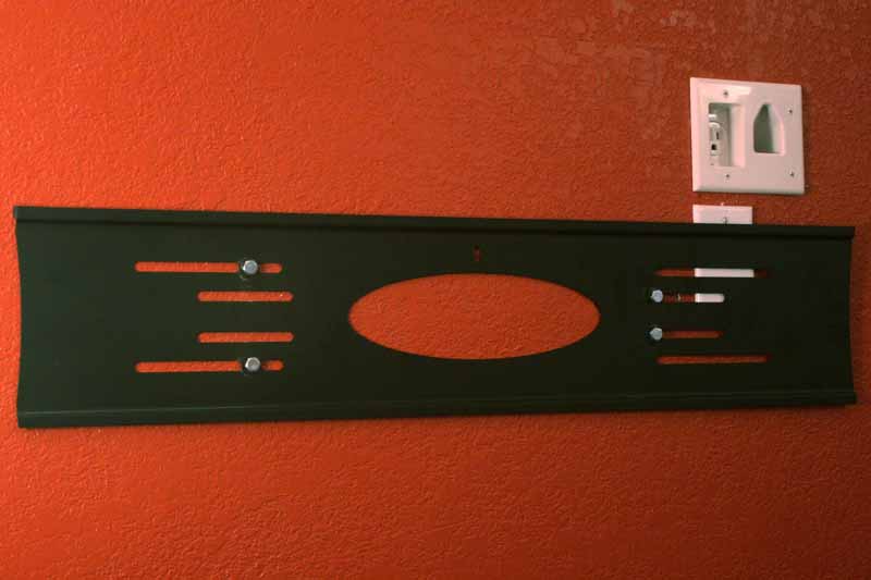

The first step was to attach the wall plate to the desired viewing position. We located the studs using a Bosch GMS120 Digital Wall Scanner (cool tool!) and decided upon the proper height for the mount (the mounting plate will be located approximately in the middle of the screen, so it's easy to position). We then used a level to mark the vertical lines of the central studs. With an assistant, we positioned the mount and marked our holes. We pre-drilled using a cordless 12V drill and fastened the plate to the studs using the supplied hex bolts.
mount plate
In our installation we needed to put the TV overtop of where an old outlet had been positioned. We opted to place a blank plate over the outlet and mount the rear plate so that it covered the plate. This wasn't a big problem since we had four very strong anchor points for the plate and everything still fit fairly flush to the wall. In a normal installation (where someone didn't attempt to "helpful" by adding power in the wrong place) you would add your own power afterwards - as we did later.

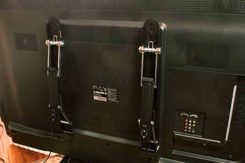

rear tilt railsWe next attached the brackets to the TV, making sure that the spring tension bolts were positioned towards the outside of the TV so we could get to them later with the supplied tension adjustment wrench. The correct screws and even the required spacers were included in the kit and it was a simple matter to get everything assembled. About the only hang-up was when one of the screws wanted to be located right underneath one of the pivot points of the arms. Pulling the tilt mechanism outward, shifted that pivot point and granted us access to the screw hole. It was almost a pleasure to work with this mount.

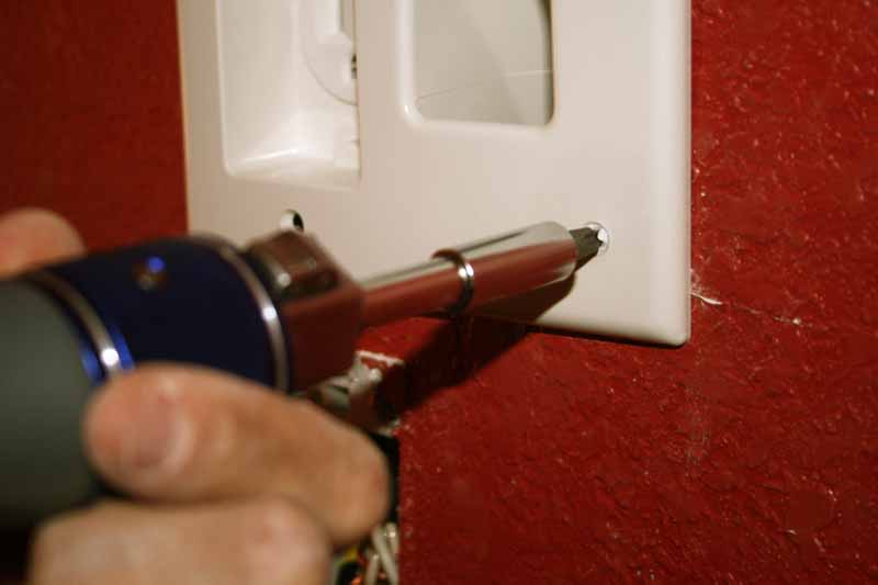

Before lifting the TV onto the bracket and installing it, we needed power. To accomplish this we utilized a Bulk Cable Feedthrough and Remote Power Interface from Parts Express. With this system you can "jump" power from a standard AC receptacle to a "feeder" outlet down below and then run it up the wall using 12/2 power cable. You can also opt to simply hard-wire the top receptacle in place, feeding it power from an existing electrical circuit. The only downside with this method is that you may still want to insert a power filter or surge protector between the TV and the recessed power receptacle. Behind the TV, you then mount the recessed receptacle in the wall. Now what we like about this system is that it comes with a bulk cable feeder (as the name implies). That means you can run your HDMI cables, component cables, networking, etc right up the wall. It's perfect for interior walls where there is no insulation and you don't have to worry about sealing up the wall from exterior air egress.

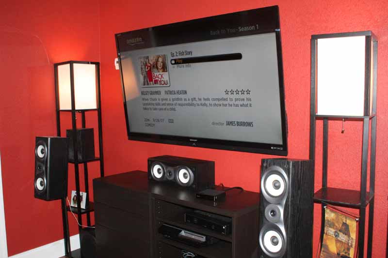

That was pretty much all there was to it. We lifted the TV onto the wall plate (using two people) and massaged it in place until it clicked into place. This was a bit harder as the lower clips didn't want to pop into place, even when pulling down on the two clip-release straps, which we later cut to length so they didn't stick down past the bottom of the TV. After a tiny bit of finagling, we got it to click and everything was ready to go.
The thing about this mount that is pretty cool is that you can slide the unit left and right quite easily to get it perfectly positioned on the wall. You can also grasp the television at the top and bottom and literally pull it out from the wall until it's able to be tilted downward as needed (up to 15 degrees of forward tilt). This also allows you excellent access to the connections for HDMI, component, networking, or whatever you need to get it up and running. And that's just what we did. We picked up a 5 meter High Speed CL3 HDMI cable from PartsExpress and fed it through the cable port we had just installed.
There are other ways to dress up this type of installation as well. For one, you can get a custom wallplate that has the exact connectors you need, allowing you to bypass the bulk cable pass-through and jump directly to a finished plate with actual terminations (we included this in our parts list above). In our case, we weren't certain what the future might hold, so we kept our options open with the use of the bulk pass-through solution.

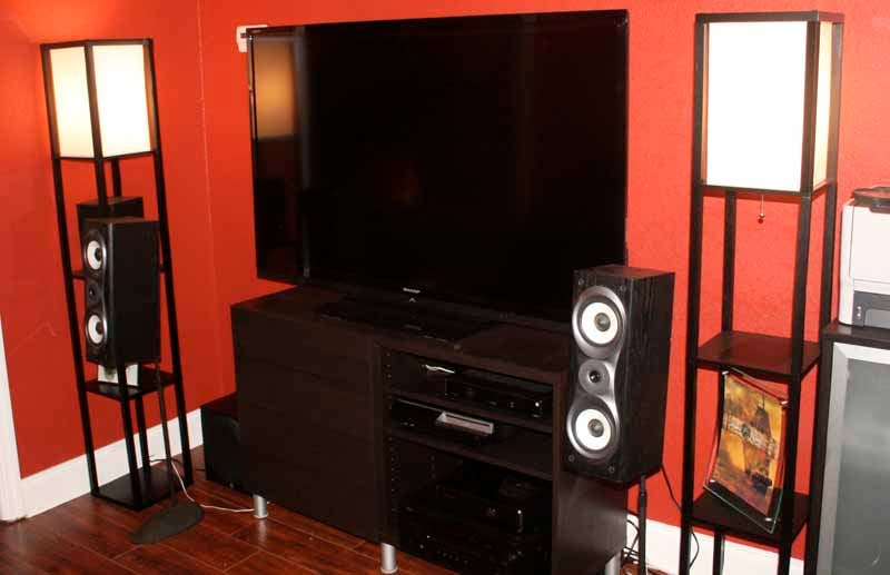

before after final installation
Before (left) and after (right)
The finished install couldn't have been better. It looked fantastic - much better than where we started - with a beautiful 60-inch TV tethered atop a component shelf. Floating your TV on the wall just makes it look that much more... flat. I mean, what's the point of a flat panel TV if it's sticking atop a piece of furniture. It's meant to be hung, and the cost and effort to put it up it is well worth it, particularly when the materials and products to do so keep getting better and better. Atdec continues to impress us with their ability to produce innovating and useful products that get the job done - with an eye to both aesthetics and ease of installation. That's a great combination to have at the Telehook TH-3060-LPT continues a fine tradition.
